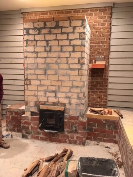

    Here’s a masonry rocket mass heater I helped design and build in North Carolina last week. Fortunately we were building on a concrete slab foundation directly in front of an existing fireplace. F53F4AE0-A06A-4C10-A573-99CF11622EAD.jpeg
    The homeowner sent me this brief video yesterday to show the waves of heat rising from the rocket:

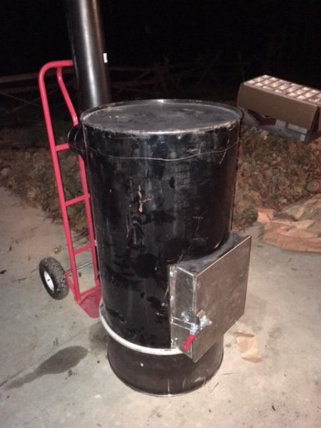

    And this is a rocket heater I recently designed and built based on straight sided 55 gallon steel barrels: 03D7584E-8308-4DAF-96FE-C654DC0548FC.jpeg 016878DE-8585-476B-A07F-7ADB487416BE.jpeg

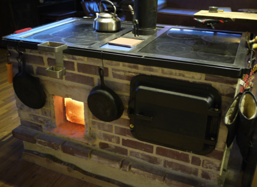

    And here is Matt Walker’s remarkable kitchen rocket: FC75A1E4-0C5B-4E9D-BAE1-E163E915DB11.jpeg

    What is the little grate to the right of the firebox door? I didn't see that in the pics on your fone

    Ash clean out door for a shop vac.
