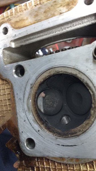

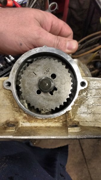

    Make sure and check your work over. We tore this bike down and replaced rings. took it for a short test drive and all was good. This weekend i got it out and was giving it one last test drive before i delivered it back to the customer. It started and ran for about 30 seconds then died with a few clanks, bangs, and otherwise bad noises. Apparently we forgot to loctite the cam gear bolt. AS 003.jpg
    and apparently a ttr125 is an interference engine. This customer gets a new valves and a valve job for free now and i get to feel like an idiot in front of them when i explain what happened.

    and as frick ups go...this is a cheap one. 2 new valve=$35. valve job is just 15mins labor to cut the seats and lap the new valves. all total its only a $100 mishap and the customer is going to end up much better off because of it.

    The cam gear is only held on with one bolt?

    one bolt....and its only a 10mm bolt on top of that. stamped steel cam gear with a tab bent over as the keyway. really cheap design. gets even worse to time this this thing...its basically just put it at TDC and line up the mark on the cam gear with the dash on the head.....there is .050 gap in the cam gear alignment tab so the cam has room to move and either advance or goober a few degrees just by where the bolt tightens down.
