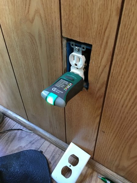

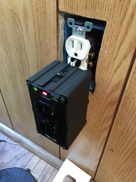

    An out of phase outlet can slowly cause damage to some control boards on pellet stoves! So if not sure you can check with a simple electrical outlet tester. I always use a Tripp Lite Ultra Block Surge Protector that checks for a good ground and phase reversal. One of the LEDs will lite up red if there is a problem!
    See pic of phase reversal below.
    Pic 1 - Surge protector shows Green & Red - problem

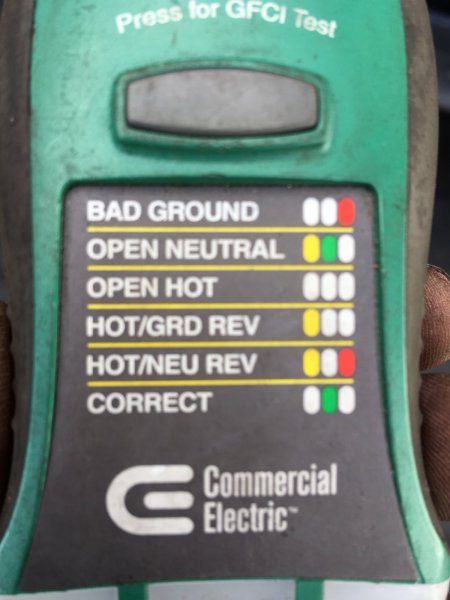

    Pic 2 - Electrical Tester from Home Depot shows Yellow & Red!
    Pic 3 - Legend shows Hot / Neutral Reversed

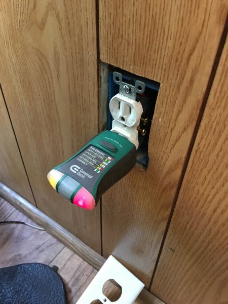

    Pic 4 - After power was turned off the White and Black wire on the outlet was reversed, it was tricky because the wires went into the quit snap in holes so to release the wires, a small pick probe had to go into the slot above the wire hole to release the tension with a pick probe!
    Now electrical test shows green for good!

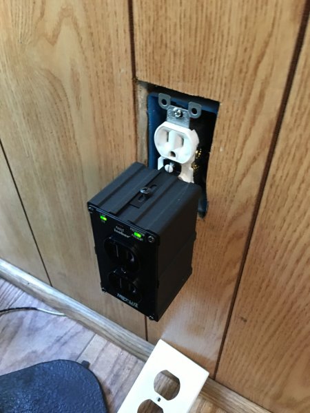

    Pic 5 - Tripp Lite Ultra Blok surge protector shows 2 green lights for good ground and correct electrical outlet wiring and surge protection circuit is working properly!
