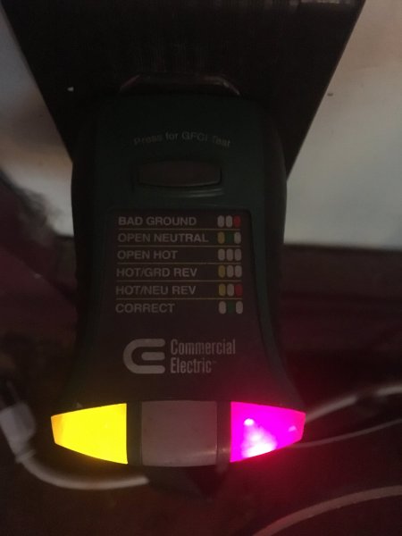

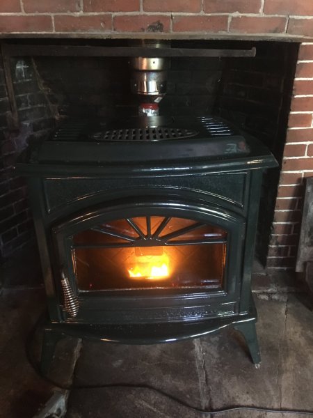

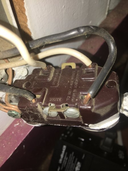

    I do not see this very often but this was in a house built in the late 1700s. The age of the house here really seems irrelevant because the AC outlet that the pellet stove was plugged into, is a new 3 prong outlet wired to a modern circuit breaker panel and properly grounded. Therefore it can happen anywhere!
    I have seen this particular miss wire blow the exhaust blower triac on the sturdy Englander 25 PDVC after approx 3 years. Then the exhaust blower would not run even though the blower tested good with an AC test cord.
    Luckily in this case, the stove was an older Lennox Whitfield Traditions T300P That was not in this house very long and it still works.
    See pics

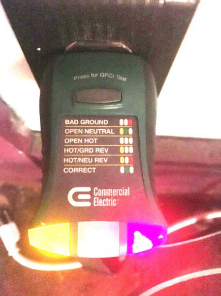

    Most folks would not give a second thought to the possibility of having a plug wired wrong.
    I massaged the piccy of the cool little meter for y'all
    A bit easier to see the critter..

    yup....we use them too on installs.....one of the first things we do....tell the homeowner what to expect on the gadget, if it shows as anything but that, they'll need an electrician to rectify it, otherwise the warranty is null......its actually not all that uncommon.
