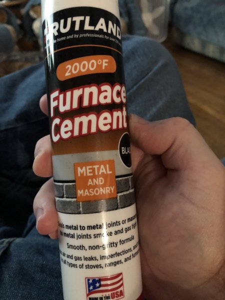

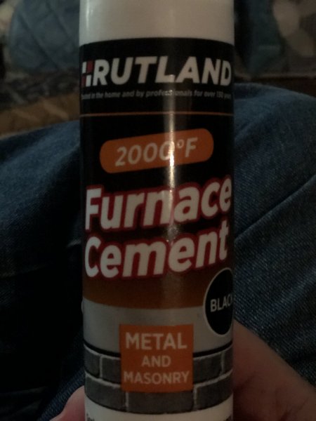

    83E7B0E1-48EC-4C2D-BE97-78154A92306B.jpeg DCBD73CB-D473-4A5E-8129-0ED2C8C34A95.jpeg All the Hearthstones I have looked inside of have a cement in them in the corners and even in-between the stones and they use it to fit cast pieces together as well. It always turned me off as being chancy, but I suppose it is necessary.
    Might be a different type cement, and it likely is, but they use it in the same manner. I agree though, with fire brick regular furnace cement likely won’t stay. I’d say that out there somewhere there are specialty type cement/sealers that manufacturers use.
    I picked a tube of this stuff up the other day at TSC just to have a tube handy. Had never seen it before. If it bonds metal to metal, then this might stay put, but I doubt it.
    Edit: Can be removed by sanding or scraping...it won’t stay either. LOL!
