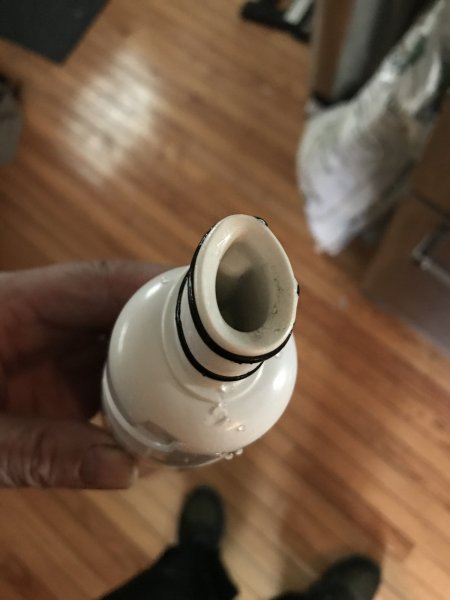

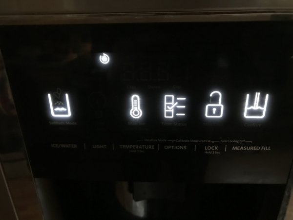

    It is a Kitchen aid and says the water filter needs replacement. It made load grinding noise so something must be wrong.
    There was no ice left in the bin.

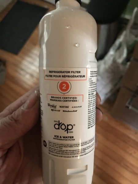

    So I removed and replaced the water filter.
    It looks like a # 2 charcoal filter.
    So I replaced it and purged out the air bubbles by running the cool water into a glass.
    No ice making that I could hear or see.
    The next morning I was sitting on the couch and I heard the familiar ker plunk sound of ice falling into the bucket. It took all day but we now have a full bucket of ice.
    Why would there be no ice when the water still comes out? At least I know now but why?

    We have filtered water going into the refrigerator
    Do you know where I can buy the bypass for the # 2 kitchenaid water filter and be done with it?

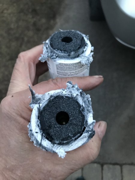

    don2222 our GE fridge does the same exact thing when the filter needs to be changed

    Double solenoid fill valve. I sell lots of valves and ice makers. That bypass plug is for the #4 filter, which is a Maytag carry over after Whirlpool bought them out. Whirlpool doesn't offer bypass plugs other than the one for #4

    Your water line that hooks to house supply is going straight into the filter housing. From there it goes into the valve, and then 1 line goes to I/M, the other to water dispenser via the chilled water "tank" which is a coil of 1/4 tubing usually. Then out to dispenser

    The manufacturer doesn't offer one. They only make one for the #4 which is a Maytag carry over. You could get a John Guest fitting and bypass the filter housing.
