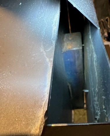

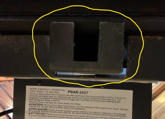

    Does anyone know what this rectangular metal box on the back of my stove is? It is level with the back bottom of the stove, and extends up about 14 inches. The bottom has a rectangular cutout in it, the top is closed, and it is inside the back heat shield/air deflector. The stove has a blower motor on the back bottom. Could it be an air source?

    There is a blower on back that blows air over this box, but I can't see how they would tie together.

    I held a lighter next to the opening of the box to see how the flame responds. The flame definitely is being drawn into the box, and the rate at which it's being drawn is enough to snuff the flame out. This leads me to believe there's an air outlet at the other end, but I'm not sure if it's the cracks at the top of the box, or if it's venting into the stove.
    If I had something that would produce smoke, I could see where it's venting to.

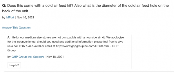

    According to a question/answer on the manufacturer web site, there is not an OAK kit available for this stove.

    The inside back of the stove has the fire brick, and a double wall of steel above that, I think a wire would have to double back downward to be seen. But it is worth a try.
