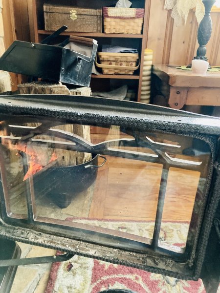

    I was not happy with how the chimney guys were replacing my gasket--never seemed to last long, came loose, frayed like crazy. Cement all over the frame. Seems every year the gasket was trash. So I decided I would attempt it myself, figured I couldn't do any worse.
    Famous last words.
    I found the correct size for the Alderlea T5 which is 5/16, No point getting it from PE, they do not sell to public, just dealers. Got a Rutland kit with cement tube,
    Used a screwdriver, wire brush and wire wheel on drill to clean the channel. Wore down the screw driver, frayed the wheel, but could not get to bare metal, so just made it as smooth as possible. Guess there was 10 years of glue in there.
    Followed all the other directions, moistened the channel and rope, gently pressed in without stretching, cured, etc.
    It looked great! For about two days, thats when everything went to He--.

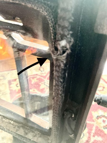

    First some of the gasket came loose. No surprise; squeezing out that stuff took all I had, and I am sure I was a but skimpy in spots. Re-glued, re-cured. A few hours later, I built the heat back up, checked the gasket, and notices some flattened places. So I decided to pinch them up, like I have done in the past my first attempt resulted in the rope fraying apart in my fingers! WTH??
    I do have some more gasket rope on order from Amazon, one is supposed to be high density, the other it 6/16, and some more cement.
    Any body know what I did wrong? Directions said to let stand for an hour, then small fire about 500 degrees for another 2 hours. Measured with temp gun, it was between 470 and 500 most of the time.
    I am terrible with pictures, but here are two.

    Sounds like you did it right. Old glue and cheap gasket maybe?
    I don’t touch gaskets after they’ve been fired. They get brittle in time, not sure how fast.
    My factory door gasket from 2013 is still in great shape per the dollar bill test. Gaskets every year sound excessive.

    I think you are much better off using high temp silicone than gasket cement. Cement gets brittle and in turn if it soaks into the gasket it makes it brittle as well.

    When I bought the kit off of Buck to do mine it came with high temp silicone vs cement. I did it again with a Rutland gasket and bought my own silicone and actually it seems to be holding up better yet.

    I used a wire wheel as well and it worked well. I think as you said in your original post just get most off and make it smooth is fine. The sealer I used was sil-bond 6500.
