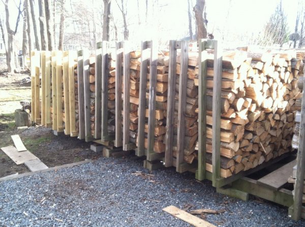

    My system consists of racks made of PT 2x4 that are 12' long and 5' high. They are
    placed on 4x6 beams near the ground (the beams are on concrete blocks) and the drying racks
    are approx 18" apart. this works good for me for the amount of room I have in my yard.
    I can dry about 10 cords at a time and when the rows are dry I mark them so I know what
    is what.
    I top cover each row individually with a piece of clear plastic, just wide enough to cover the ends
    to shed the rain water off and away from end grains. This system gives me plenty of air circulation
    and sunshine in the early-mid part of the summer.
    I don't have room for a shed so I leave the dried wood in place until it gets moved
    for stacking on the covered porch in early October. The porch holds about 3.5 cords and will last
    me until mid february.

    Found a pic from March 14'

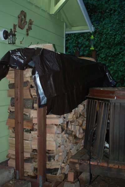

    Here is about one cord of my storage currently:
    The front posts are six foot tall and the back is at seven foot. It is eight foot long and double stacked. All the wood is up on pier blocks that had the strap embedded.
    Excuse the hot tub. :( In spring it is going to get a new deck. The wood storage shown above will rotate 90 degrees and be between the hot tub and the hill.
    I'm going to have something that looks similar for the second cord behind my shed. As you can see in this picture, the house "butts" right against a hill side. From the hill shown to the front of the lot(creek) is about thirty feet total.
    Using the picture above, should I pull the tarp upward any? Or is it in a good spot and ready to get fully secured?

    You've got a good rack set-up. Looks like your roof over hangs a bit? That helps in the back. Any way to get your tarp on top of old pieces of plywood or short boards... to hold the tarp out about 6"-8" in front of all of the splits, so water will drip in front? If possible, slope those plywood pieces a little to the front. Then, weight it down again, like you have now. Single most common complaint I've learned here is to do anything needed to avoid pooling on top and water running off and down on the ends of the stacks.
    Shawn Curry, papadave and Lil'John like this.

    The roof extends about 2 foot from the house.
    I could easily buy some plywood to extend the edge out a bit beyond the wood pile.

    If you did that, it looks as tho you could easily add horiz 2x4s at the tops of your end posts... to attach the plywood to if you wanted... might not even need the tarp then. Mini wood shed... ;)

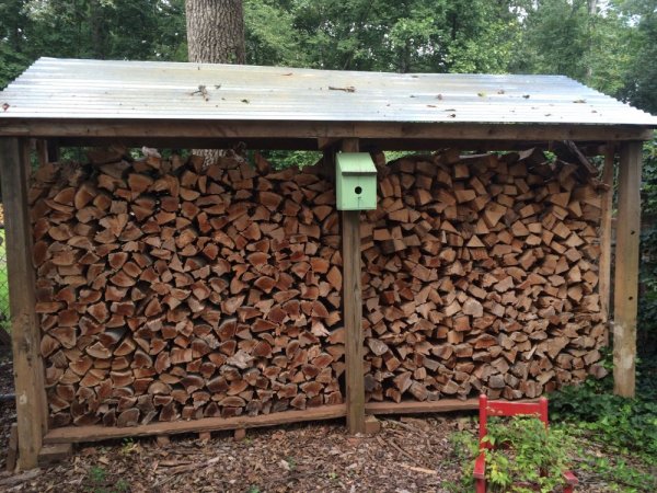

    That's almost exactly what my mini shed is. I don't have any good side pics, but you can kind of see the slope here. Taller posts in back, all framed with 2x4s and a metal roof on top of that
    John, it wouldn't be hard for you to do something similar with your stack

    Long term is to have three storage areas like my picture that will try to match the roof but also not be against the house.
    My winter goal is to keep my current supply dry by any means. It looks like I should add a piece of plywood to my current setup to better cover the wood but also prevent puddling.
