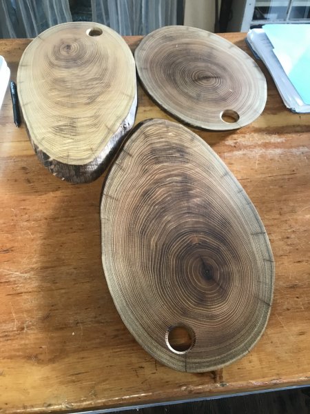

    I had these slices cut out of a fairly dry Black Locust branch. You can see a little checkin on the outer perimeter but it never progressed further.

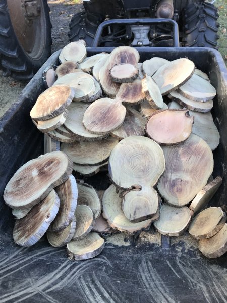

    I did a little experiment this winter. I had cut a bunch of small cookies on my cordwood saw for a projecT I thought I might get to this winter. Never did get to it but here’s what I did. I piled some of the cookies around the back of my woodstove. Yes, torture.
    But anything that survived without checking is now pretty much guaranteed to never check. Mostly the dry barkless Black locust without double piths survived. Some cherry checked up. I have t actually gone through them all but guesstimate 50% survived. Mostly because the wood was pretty dry already and BL seems to take it better than other species.
    These are some of the cookies I tortured.

    I should note, just like your cedar, the small peripheral cracks in my BL cookies were already there before milling.
