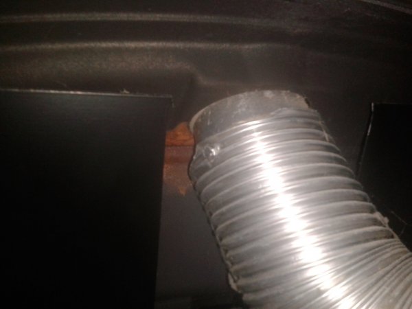

    Besides for some rust at the inlet of the stove, I haven't had any issues. The oak only runs around 2' from the outside of the house running parallel to the stove. I used ss ducting too. I think it doesn't condensate because
    of the short run. By the time cold air comes through it, it warms/dries from the radiant stove. How long is your oak?

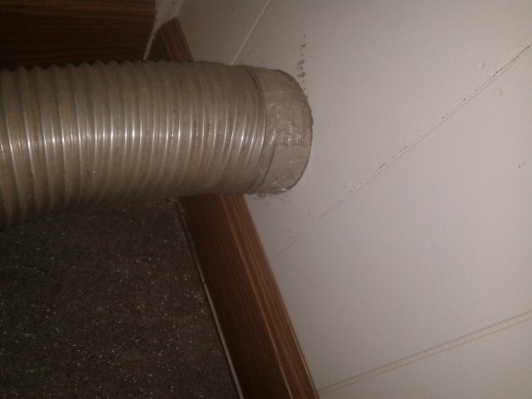

    It's flex aluminum connected to the aluminum dryer vent pipe coming through the wall.
    Maybe 3' or a bit more, not including the pipe through the wall.
    I've since foamed some around the pipe, but the flex is still condensing.
    Even if I insulated and sealed up the wall, the flex will probably still sweat. As long as it doesn't get in the wall, it's less of a problem but the drips were noticeable.

    Your not much longer than me.....hmmm..... I have some rust there, but I haven't noticed any drips. Insulating it would be best if it's a concern while keeping clearances. Here's my mess.....

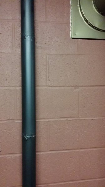

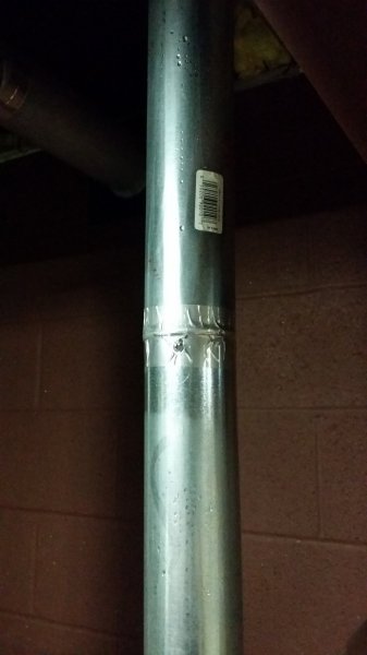

    I get some sweating, but use a small pan to catch it on the pellet furnace.
    The wood stove has just as long of a run, but since I painted the pipe black? I do not have any sweating. . At all.
    Maybe the black pipe warms it quicker? I am not sure, but I plan on painting the flue and OAK of my Pellet furnace black this year to eliminate it.

    Both stoves are currently running..
    Painted pipe has zero condensate.

    I'm thinking the black pipe collects more heat? Or it could be that it's near the wood stove and their is more radiant heat? But then no one would have issues with a wood stove OAK?
    The black paint is all I got..?..? I will be painting the OAK on my Pellet furnace as well. Just to settle the myth in my head. :)
