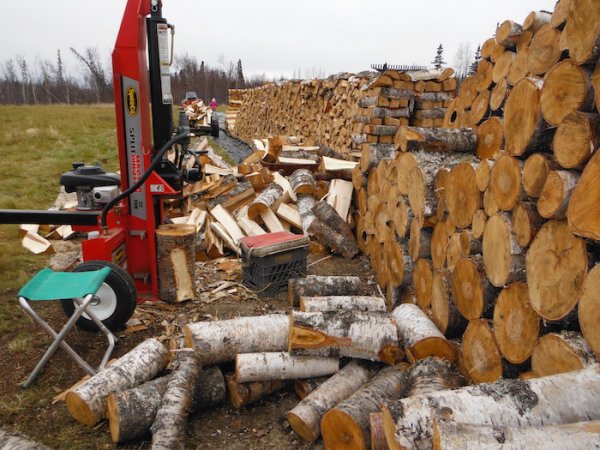

    Being a old fart, with a bad back , set in my ways:
    I roll several rounds to within pic-a-roon distance of the splitter, start the splitter,
    sit down, stand up the rounds onto the splitter shoe, pull the lever to split the round , toss the splits to a pile.
    or
    park the splitter by the pile of rounds & start splitting:

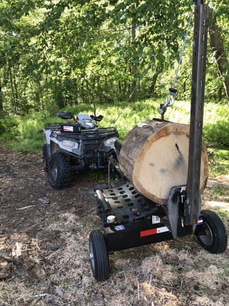

    I made one that runs off my atv winch. Atv has a front trailer hitch so it seemed logical to just use that.
    As with most improvements I’ve made once I used it I wouldn’t ever want to go back. I’m never splitting vertical, no longer swinging a sledge and noodling is only fun for so long.
    Is it slower than picking up a 200lb chunk of wood? Maybe, but I’m not picking up no 200lb chunks of wood either.
    on oak I use a rafting dog. Three good whacks with a 3lb hammer and it’s secure. On ash I’ve found the dogs don’t work as well. I switched to the log tongs I use on my other winch operated equipment. (Log arch and log trailer)
    For the dog I welded a small piece of round pipe on the back of the support. So whenever I release the dog I just tuck it in the pipe out of the way. The tongs are faster but I’ve yet to come up with a method where they’re not in the way somehow, or at least the rope ;)
    Biggest issue is longevity of the remote batteries. Even on my relatively expensive Polaris atv winch the remote battery doesn’t last long. Seems to lose the ability to transmit more than a few feet rather quickly. Can be a real PIA.
    I also wired my atv winch to accept a separate 12v deep cycle battery. Atv batteries are already skimpish on amps.
    synthetic over cable everyday. Didn’t think I’d like synthetic but I have three winches with it now and I’d never buy anything else. They have 1/4” rope rated for 15,000lbs now. Insane.
    Not so sure I’d like the dc wires running up the pole to the winch. I’ve seen many instances splitting the big ones where they may get pinched. It happens.
