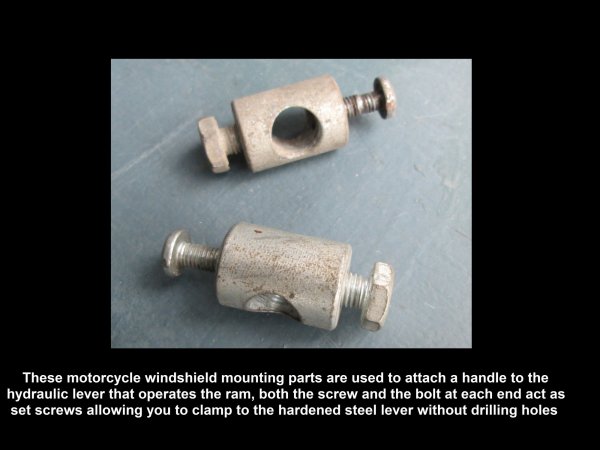

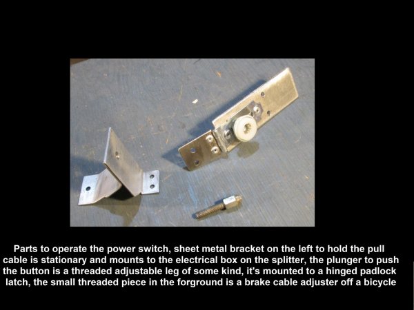

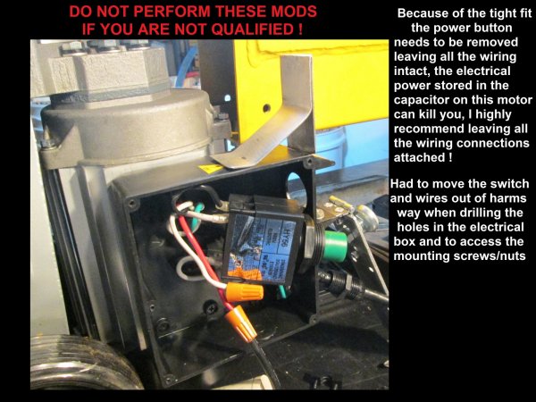

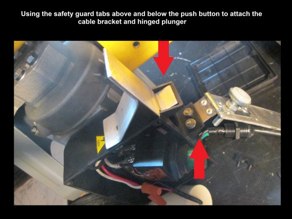

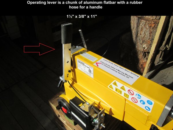

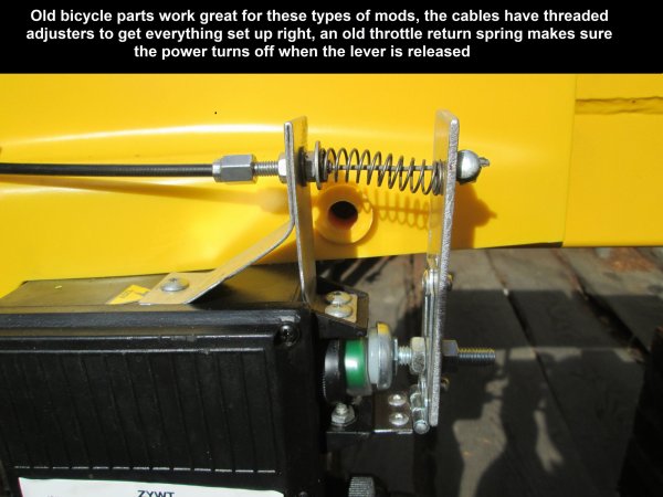

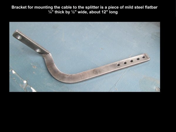

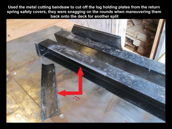

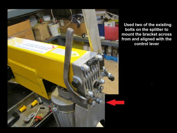

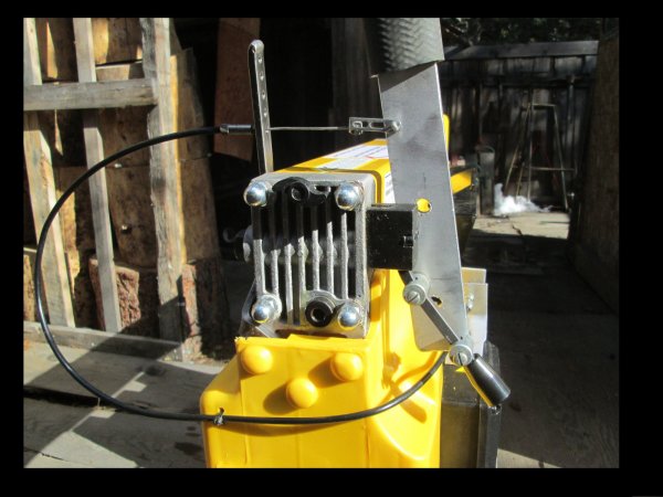

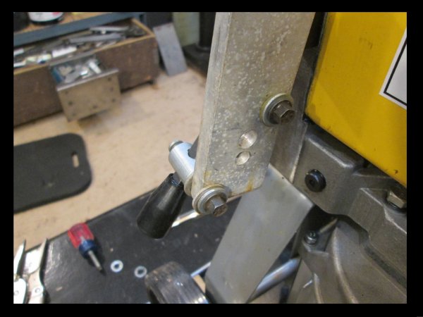

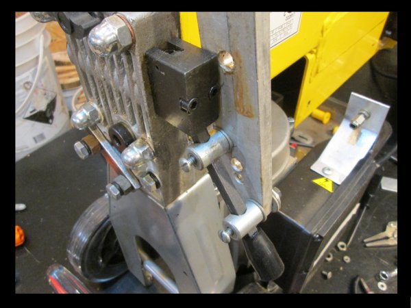

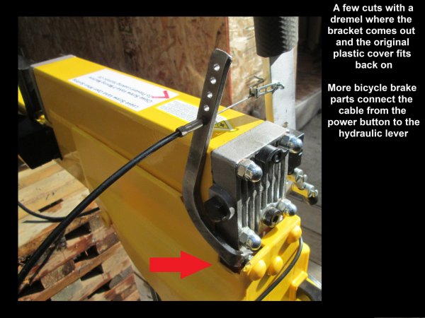

    I picked up this wood splitter on sale at Princess Auto, for less than $ 300 Cdn on sale it's an amazing performer, I've gone through about a cord of wood so far, some of it was 22" diameter the splitter had no problems at all, very impressed. What I wasn't impressed with I changed, a two hand operation splitter is safety overkill so I'll include the mods I made to convert it to one hand operation, the only other problem with this splitter is also related to the two hand operation idea, with both hands occupied you can't hold the round in place so from the factory the splitter comes with these angled plates to hold the round from falling off the deck, these are fine for awhile until you notice how much they snag the rounds when your pulling them back onto the deck for another split, those are gone now, otherwise this is a great little splitter.
    If you have any questions about the mods feel free to ask.
