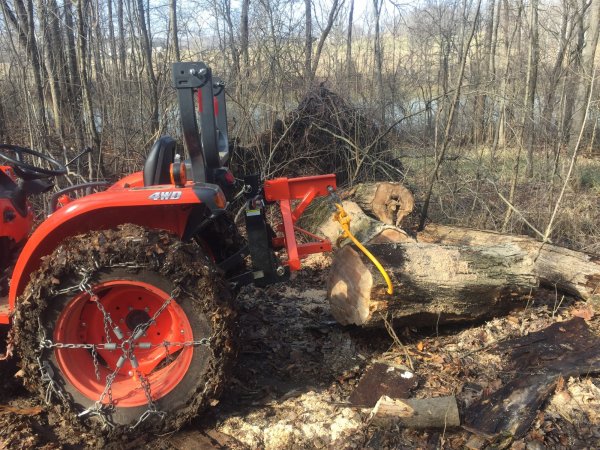

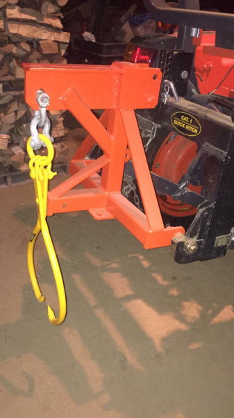

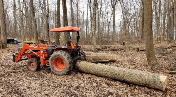

    307F3BEF-DF0B-4322-9AD8-42981D660923.jpeg 5EF13E0E-F7D4-42D1-9701-D20AC8253B29.jpeg F83B407F-0918-4DA0-8F5D-A9AFD027C330.png This took some Fab work but it works great.

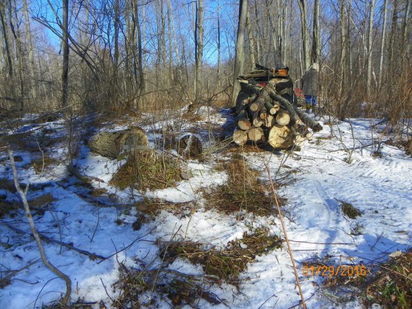

    20200222_093148.jpg Log skidder & snow?
    20201010_130843.jpg Hydraulic winch on a small loader tractor?
    Build a dray to haul them out on? Honestly, a log dray is cheap & quick to build & really works well.

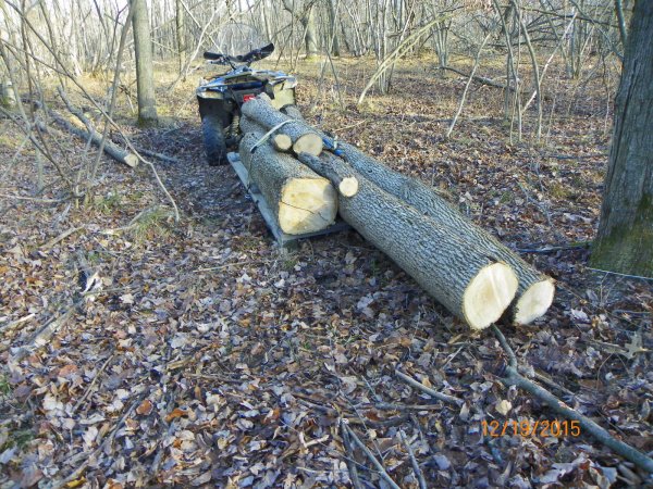

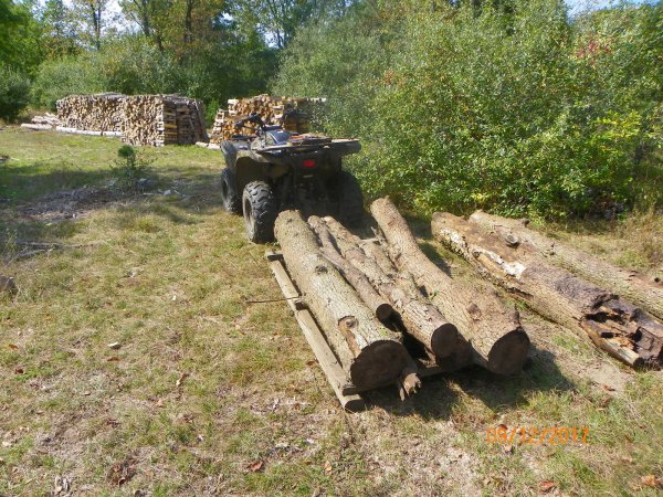

    268,764

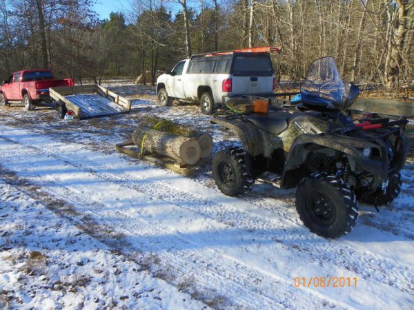

    If you want to keep it simple and very little cost, you can throw together a dray in an hour or two. The one I built cost me around $10 and it works so goo I can use the atv for hauling logs. But remember you can build to any size you want.

    It was my idea but I can’t take credit for the welds. Welder at work welded it for me. He is as good as it gets.
  9. Flamestead
    Flamestead
    Dec 7, 2013
    2,076
    10,327
    Windsor County, VT
    I love a good fab job. Note that the top link is the weakest part of the 3pt - most tools are built to pull in line with the lift arms. You see very few 3pt backhoes of any size because of this.

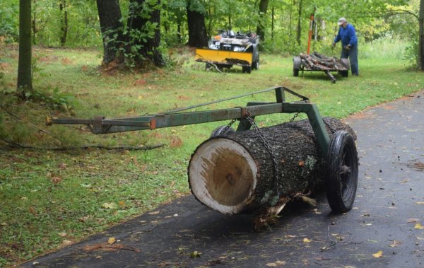

    I've used this a few times to move logs. I made a hitch adapter so I could use the ATV or tractor to pull it.
