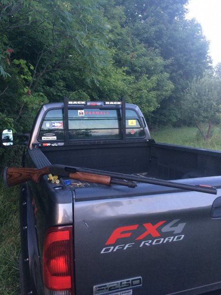

    Thinking about building some sides for my 06 F250 long box just curious what everyone else has done. Here's a picture of the rig right now, excuse the shotgun haha

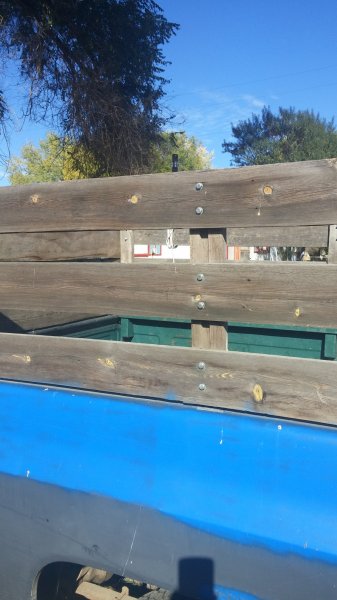

    Here is woodracks on my 77 chev. This design is common is my area. Some folks bolt them together some use woodscrews. 1021151123.jpg

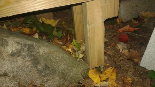

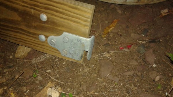

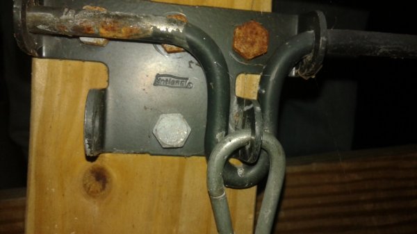

    1445465908804.jpg 1445465940696.jpg 1445465979919.jpg Sorry i didnt put these stake sides on the Ford F250, my truck box is still on and its getting dark. However i did manage to take pics of some key points. One pic shows the angle connectors. The bolt on each of the corners of the sides, and mate together. Another pic is of the levers for the back and the last pic shows how i cut the uprights to fit in the bed pockets.

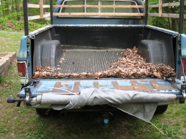

    1x1 square steel tube with some ripped 2x4's I wanted the space at the bed level big enough to fit my arm through for my bedroller and get stuff front to-back without having to climb in.
