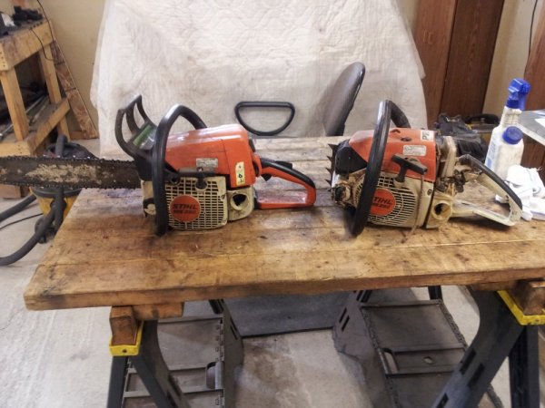

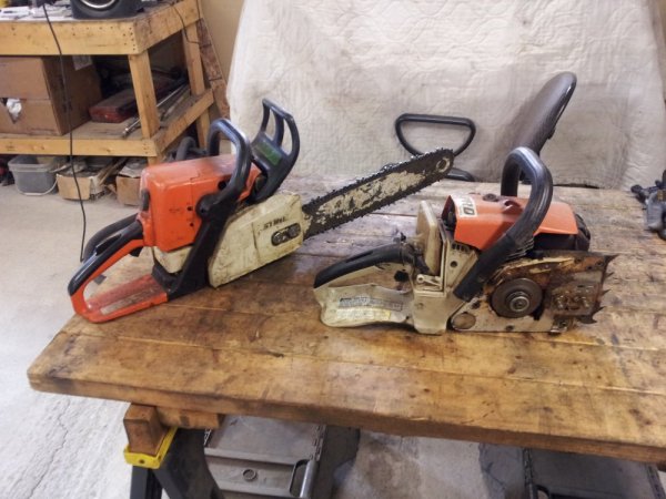

    Thanks everyone. This free deal just got a little better. Turns out he also had an MS250 he didn't want anymore as well so I ended up with 2 saws. :D The 250, I'm told, ran but not well and would die if you let off the throttle and needs a gas cap. Pulled the muffler and no scoring on the piston, rings are free, and no carbon in the muffler. Has good spark so I'm off to the Stihl dealer to get a gas cap and maybe a carb kit since they aren't too expensive and if I need it this weekend they won't be open again until Monday.
    The 260 looks like it was hit by a train so that one might sit until my usual winter work starts coming into the shop and I have the extra money.
    I don't have a picture resizer program on my home shop computer so I'm going to try to upload from my phone.
  15. Bret Hart
    Bret Hart
    1,061
    3,817
    Central NY
    Pics as promised. Sorry for the delay.

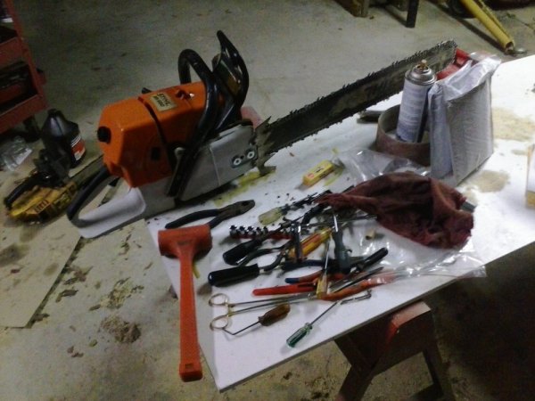

    Try hultz on ebay for the plastic. That's what I used on this crushed 650 I just built. The plastic and tank handles are cheap but from what I have found a ggood replacement. They have buy it now prices and auctions. If u best offer or win an auction u will save $10 over the buy now price.
    All plastic and handle was $69 shipped.
    Here is the 650 done.
    Bret Hart likes this.
