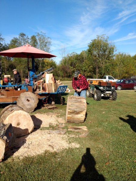

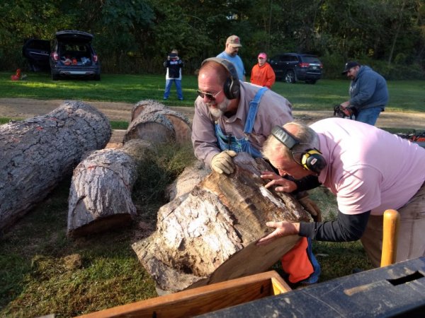

    At a recent gtg we had some big stuff to move around and there are a couple ways of doing it. The first way is to use lots of muscle.

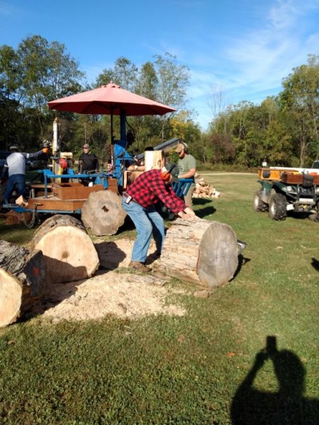

    Now comes the pickeroon. I watched a few of these logs being moved then picked up my pickeroon and easily moved some logs over to the splitter.
    Here I was just turning the log to point it in the right direction.
    The reason for this thread is just that it has gotten me curious over the use of the pickeroon or how some folks use it. Personally I've tried to use the pickeroon a few times for moving some firewood but found it took way too much work, but maybe that is because I have such a bad back and hips that slow me down. Therefore, I use the pickeroon to move logs (Small and large alike. Long and short alike). When I pick up firewood (and sometimes long logs) I use the tongs. It just makes the work go much easier.

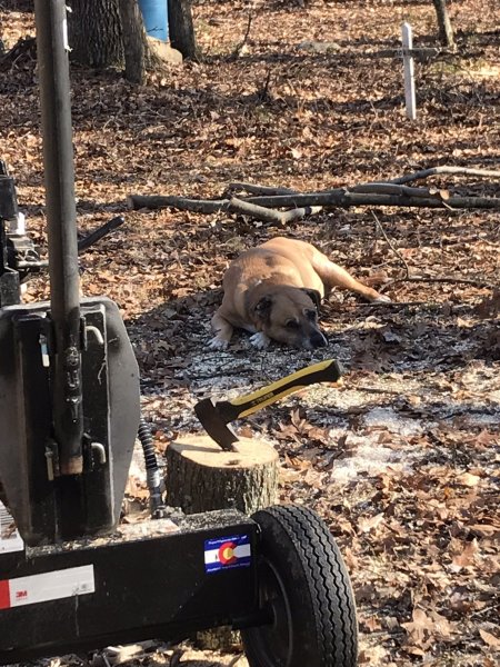

    I made a hatcharoon out of a dime store junker. If I have to pick up rounds I’m using it. My spine doesn’t mind as much picking off balance with one arm. 40 years of masonry it’s used to it. What it doesn’t like is the bending forward and picking up with two arms which requires much more bending.
    Just a pic where it’s in it. I keep it next to the splitter lightly plunked into a round instead of dropping it to the ground. It’ll grip a 150lb oak round without pulling out. That’s more than I’m picking up on any regular basis these days anyway. The real heavy ones I can use a bowling type swing to get the round one handed onto the splitter bed without it letting go.
    Ash is a little funny wood. Doesn’t grip ash as well I’ve noticed. Has to be in the end grain for any decent grip.
    I sharpened what would normally be the top of the hatchet. Left the cut into the blade flat. Theory being when wood is hanging it’s resting on the flat edge and the blade and top edge are attempting to cut deeper. I think it works. If I had sharpened all the edges I doubt it would hold as much weight as it does.
    The birds mouth acts as a fulcrum. Along with the sharpened top edge you give it a whack on the handle and it lets go nicely.
