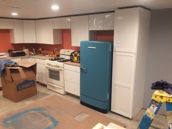

    Painted the frig surf color, range and dishwasher next.

    I like it!

    Goes well with the terracotta.

    Coral?

    Nice color IP.

    Coral, going for the beach feel. Sea shell cabinet pulls, gray weathered wood flooring this week. Will be done for Thanksgiving, pretty much flooring and trim.

    Love it!
    What brand paint you use?

    Interesting. What kind of spray gun are you using? Is that soffit on your ceiling?

    Krylon, not as good as their older paint. The Govt made them take out all the good stuff.

    Krylon rattle can, the new nozzles they have spray nice. Wife had already bought all the cans otherwise I might of tried to get a quart somewhere.

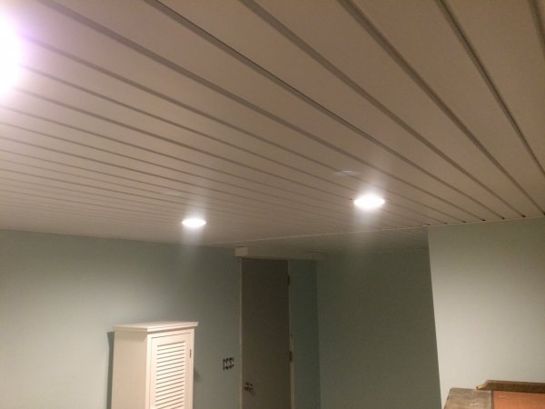

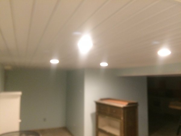

    Yes vinyl soffit, two reasons
    1) it only takes 3/4" headroom away
    2) you can easily unsnap it and gain access to anything above it. I use 3/4" pan head screws to attach so I can back them out if I need to remove the piece. Because the vinyl is inside at a constant temp. floating it is not critical like outside.
    A couple more pics
    they actually make a T strip for butting the soffit, it will not interlock like siding. I tried something different on the one long side, I butted the seams and taped the seams with white duct tape. Looks OK but I might pull it all down and run the T strips after the holidays.

    I like it - and the ceiling too!
