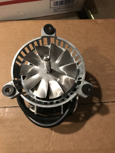

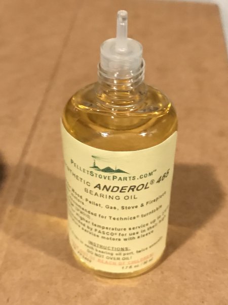

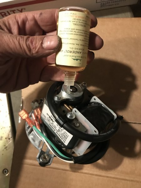

  16. don2222
    don2222
    Nov 10, 2013
    3,263
    4,422
    Salem NH
    Hello
    I actually believe that open frame exhaust blowers that Harman use, that do not have oil ports like the closed frame blowers that Whitfield and other stoves use can actually benefit by oiling because applying oil to the input shaft that is extrudes beyond the seal does allow oil to seap in and lubricate. This application has quieted noisy blowers in my experience. I have also seen MDS sheets on these pellet blowers that do in fact specify and recommend light weight machine oil and I use and highly recommend Anderol 465 synthetic bearing oil that Dr . Whitfield recommends for his blowers.
    I also have talked to an Engineer who works in the manufacturing plant about the exhaust blowers they make for Harman stoves about what the leading cause of failure of these blowers when I was researching the differences in longevity from one pellet stove to another. The main cause is heat and I found from taking thermal measurements a range of difference in the heat build up around these motors from one type of stove to another.
    I can get a professional engineering statement about lubrication if needed but he may concur that additional lubrication each year will help replenish the original lubrication that is lost from the heat and normal usage of the exhaust blower.
    Just my experience. See pics below.
    Luneyburg likes this.
