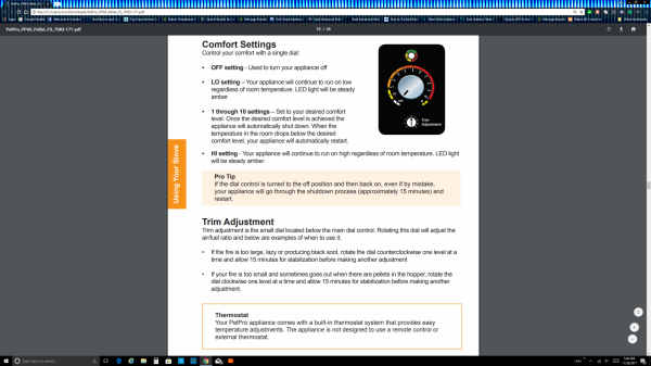

    Odd she's not getting a code though. Lori, is the stove on a thermostat?
    ivanhoe, imacman and slvrblkk like this.

    Pretty sure Pelpro are chain store only sales
