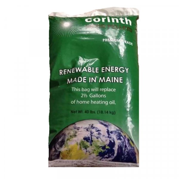

    I wonder where they sell them? No one talks about them on this site and I don't see them for sale anywhere around me. I know talk in the past has been that Corinth exports most of their product. Maybe that's true.
