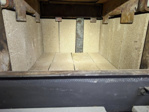

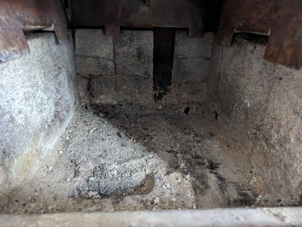

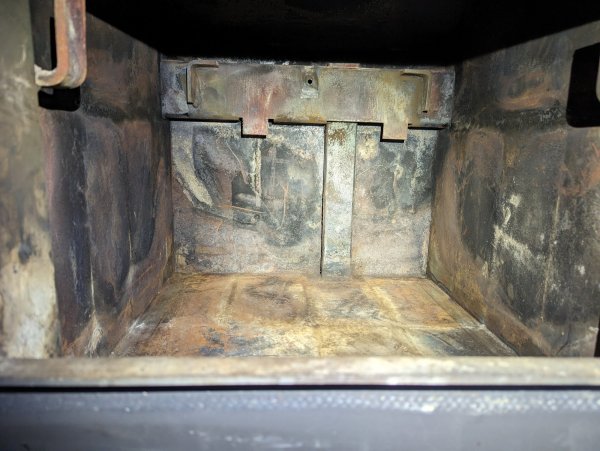

    It's 56 F outside, so we shut down the stove and replaced all the fire bricks. They were in pretty rough shape. I replaced the "baffle blankets" and pipe earlier this year.. Basically, back to new. I love the super simple but effective design of the PE firebox. So easy to perform routine maintenance.

    Looks pretty spiffy with the new bricks. I also took advantage of the warm temps and dropped the cat shield and vacuumed the ash off. Couple spots on the ceramic cat starting to degrade so I will get a new one before next winter. Had the stove fired back up once and it still works for this season.
