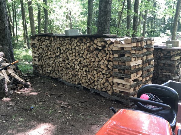

    I stack across a slope. I use cinder blocks, cobblestones and bricks to support my pallets. The supports are set into the ground with the cinder blocks being on the downhill side. Each pallet is made level but the pallets in one stack are usually not level with one another. Having the stack run generally downhill allows me to stack to a uniform height of 54” while still having water run off of the metal roofing in one direction. Here’s a pic of the setup and a finished stack on those same pallets. Each pallet generally has 8 supports.

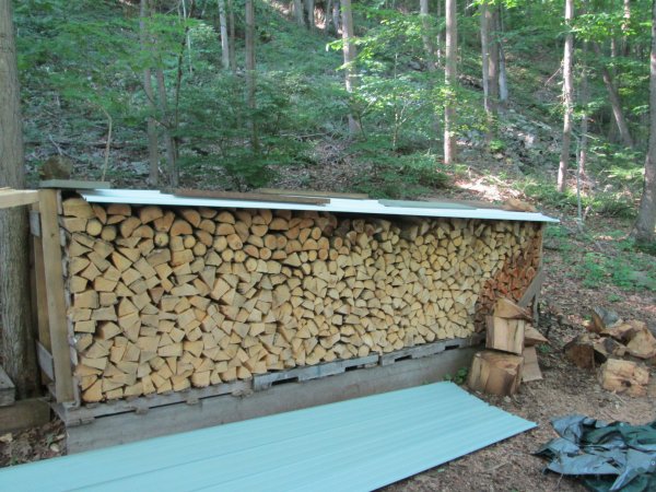

    I built this stack into a hill. The front edge of the pallet rests on a 2x12 and the back on grade. The pallets are 40"x48". I did it rather hastily. The 2x12 slopes to the right downhill, which turned out to be a plus when i covered it with metal roofing couple weeks ago. IMG_0609.JPG
    double row stack of 16" long splits. I put a pallet vertically against the tree to save time so i dont have to criss cross (crib) the ends.

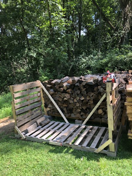

    I built these today, I’m gonna try a couple and see how they work

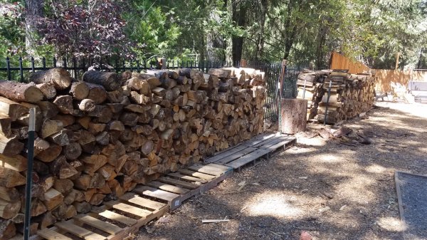

    I use t-posts for the ends. Ive tried cross stacking but because I hand split getting consistent splits made it more of pain than I was willing to put up with. Works good for us. 20180908_135356.jpg

    Glad to help. Those look like 40x48" pallets that i use. Simple and effective wood rack. Nice work Andy8850
    Keep in mind i now have triple the wood i normally do so im constantly reinventing my PA and stacks.
