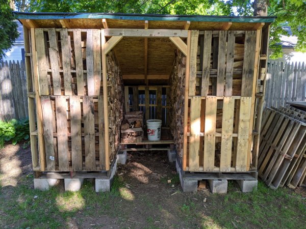

    The "Pallet Palace". Still a work in progress.
    JDU, PatrickNY, Brokenstone and 39 others like this.

    Rainking63, that 'pallet palace' looks great. Curious, why is the slope of your roof so much?
    Would be great to see more pics of your palace. Kind of unusual, what with the cinder blocks for a floor base. Cinder blocks... maybe those are called concrete blocks these days, lol.

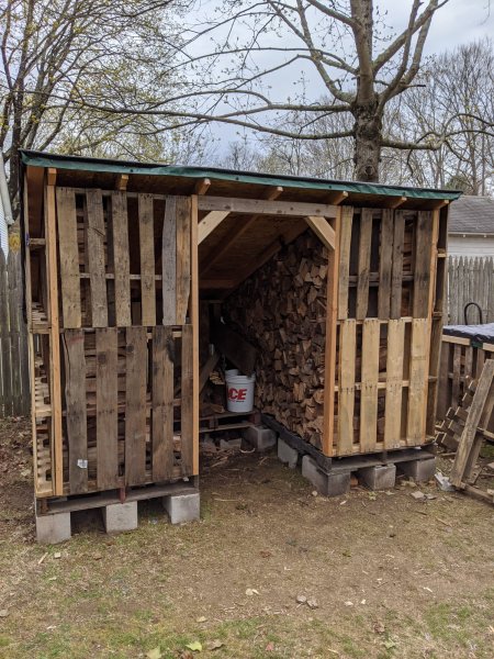

    Thanks for nice comments.
    The crux of the whole project was to try to use material I already had and not spend a lot. I built it a month into quarantine and I was out of work, so being economical was paramount. I had built a raised bed garden for my wife with the "keyhole" footprint and figured I could apply it to the shed. If needed the keyhole is pallet-sized so I could fit another one in there to stack more wood on. As far as the slope of the roof... eh, I dunno. I just picked an angle and went with it. My father has some roll-on roofing for me that will be going on before the snow really hits.
    It holds roughly 2.5 cords, and that's about what I burn in a season. And it's about 10 feet from the house, so running out in the rain or snow, if need be, isn't too uncomfortable.

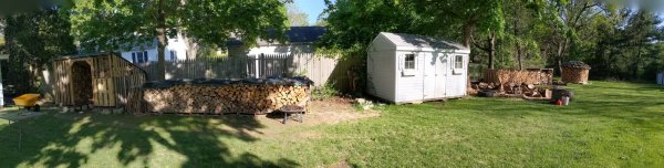

    Here's a couple more pics. IMG_20200423_123739.jpg PANO_20200520_175132.vr.jpg

    Rainking63, glad you came back, your place looks great, your wood stacks are nice. I see a holzhausen that looks great. If you have pics of that, please post!
