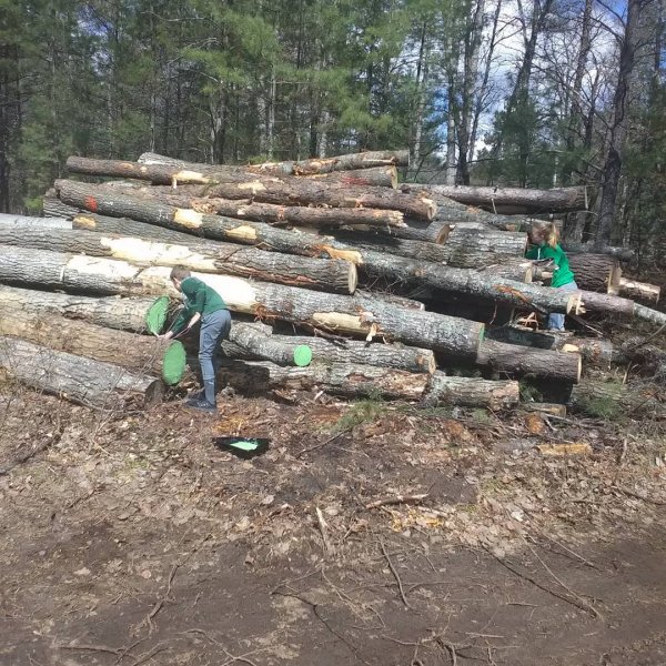

    I was told to use anything Latex. So I went to the store and picked up a can of the cheapest miss mixed stuff they had and put the kids to work.

    and you have quite the pile there.
    You need to have a couple more kids to help you catch up !

    Ha, no more kids for me! Snip Snip, knot, clamp, cauterize. Two was plenty!
    They are great helpers for stuff like this though. Makes it pretty cool to do together.
