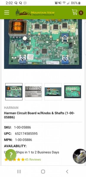

    Anyone know difference between the harman cicuit board and the Platinum control board? I assume diiferent algorithm. Besides price..

    It is just the latest board series,has been out for a few years. They make the stoves burn a bit different, convection fan runs more, and combustion fan runs different. I learned of this from Don. In my opinion, my stove runs cleaner. The part # is 1-00-05886. Then there is a suffix, such a A or D, witch is same programming, just production date. If money is tight, I see ESES has some "refurbished" ones listed on ebay, but I would call them direct and make sure it could be returned. HARMAN Platinum Control Board 1-00-05886 OEM - Seller Refurbished | eBay

    OK I had posted that reply to another member, thinking it was you. I just called ESES, and the"refurbished" boards, are ones that had been returned to them, so they cannot sell them for full price, as Harman has a no return policy on electrical parts, so no full warranty. However, they are fully tested. As far as the "platinum, that is just a name they gave to the latest generation of the most common board, that fits most stoves, the 5886 series boards. Now i see some places are calling them the 4 output board,lol. Marketing, as far as I could tell.

    Just ordered a new board with new knobs/shafts past week from mountain view stove parts. 229.00 and got 20.00 off so 209.00.

    New board installed. Dip switch change from original board. Ignitor shuts off finally.

    Btw: my stove was born in 2012 and bought new from the floor in 2014. The original citcuit board was stamped 2010 thus the dip changes. Other than 5 staying the same, three of the dip switches we're different positions than the original.

    yea.....a good point.....if you replace the board, DO NOT use the "old" board switch settings. Just read the instructions included with the board and use those. They might be the same, but then again, they might not.
