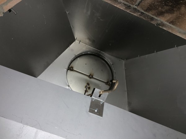

    Ok, thanks. The chimneys are inside a lumber frame, so I am guessing they are double walled already. The fireplaces are masonry and then they connect to the chimney above the flue. I hope I am getting this terminology correct.

    Man that looks hardly, if ever used.

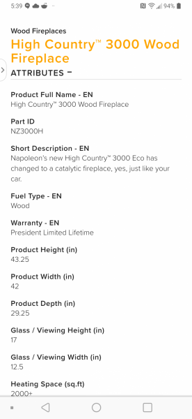

    I'm not one to start telling someone else to do- and I hope some other guys can jump in with some better advice than I'm able to give, I did a little looking and the Quadra-Fire and Blaze King models are pricey- above 3K but that Napoleon is above 8K. Its absolutely none of my business what your finances are and what you're interested in spending, so that's something you'd need to take into consideration for yourself.

    Hmm...chimney is in a chase and you have a masonry fireplace? Sounds unlikely that it is a real masonry fireplace...probably a stone veneer with a prefab fireplace if my guess is right...have any pics?
    Looking at this pic again (on a bigger screen, not my phone) this really looks like a prefab fireplace...if so you probably can't put a wood stove insert in it without tearing everything out and starting over. Most prefab fireplace manufacturers don't allow for a stove to be installed inside them...so against code...and dangerous to boot. There is usually lumber framing too close to the metal of the fireplace for solid fuel stove use. Plus there is no way to make a positive connection to the chimney with this setup (unless it has an 8" chimney, then it could be lined to 6", which most stoves run 6")

    Well, I crawled into the fireplace to check it out, and found a concealed nameplate, you are absolutely correct. The sellers told me the fireplaces were rated for cordwood when I bought the house. The chimney runs right next to my sons bedroom. I can’t thank you enough for pointing that out!!! My ignorance could have taken the greatest toll.

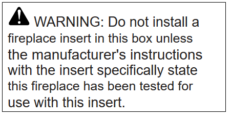

    They still could be...you will have to run the info that is on the ID tag you found to see what they say...but even if they are rated for cordwood, that is only if burning in the fireplace as designed by the OEM...as soon as you slide an insert in there, it becomes an illegal and dangerous install. Seems counter-intuitive I know but I have had this convo with a chimney pro/stove installer a time or two and turns out it really does make sense once the details of it all are explained...which right now I don't remember the particular details that clinched it for me...but I do remember it seemed legit.
    The one that does come to mind right now is the chimney connection issue that I mentioned earlier...

    I found the full manual, it’s a Desa GM42, so it has stainless interior wall and galvanized exterior. They say it’s rated for wood, but the company has been out of business since 2008 so I can’t ask about anything else. What a waste of money to install these things. I have two in the same chase in my house.

    I leafed through the manual real quick...found this on page 2. Sounds like you could put an insert in if you can find one that actually tested a Desa GM42...
