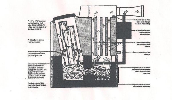

    35 years of operation has paid for itself many times over.On a yearly average fire every fourth day .
    Never have to clean the chimney .

    That is a interesting diagram - aka rocket stove- modified of course. Beats the central boiler ( a shell of water surrounding the fire) and others of similar ilk by a long shot.

    I was thinking the same exact thing. The central boiler design is pretty bad.

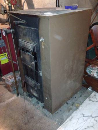

    This is a our first boiler. It burned 22 cords in the first year of operation and I just could not picture trying to get 60 cords ahead, let alone finding space to stack that quantity of wood so it got sold.

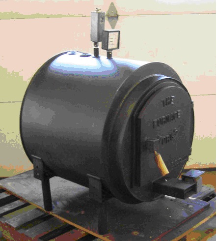

    This is a picture of a Tasso boiler that looks like our second boiler. It burned 16 cords in the first year and 10 cords in the second year when I connected it to 1,000 imperial gallon heat storage tank. Back in this period I did not understand the need for boiler water protection so creosote build up in the boiler and the chimney became a real problem; with the only way of keeping the chimney clean was to have a chimney fire once a week. While we owned the Tasso, I discovered the Jetstream and gasification. The Tasso got sold. The Jetstream was installed in its place and I have been happy every since. CLEAN CHIMNEY and ONLY burning 4 cords a year.

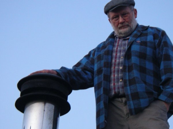

    The Jetstream achieves 98% complete combustion and heat exchange efficiency's of 85%. The picture below was taken at mid burn. The air coming out of the stack is just hot enough to be uncomfortable to breath with no hint of smoke smell.

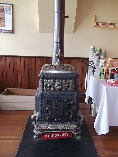

    Stoves like the one below would burn fairly clean with dry wood for one main reason that they were not airtight and would still burn briskly even with the draft and damper closed.
    To my knowledge, the fisher stove was the first true airtight and could be loaded up with green wood an would smolder for 12 hours or longer with a full load.
