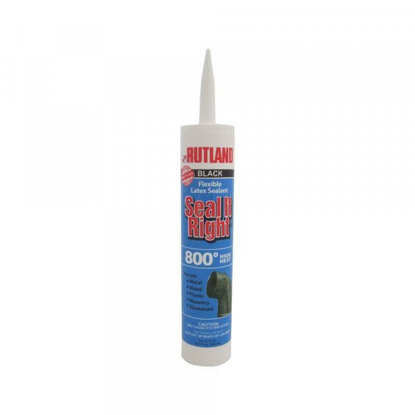

    Welds can be ground off if needed and you were worried about keeping in original, also you could put a bead of this around it.

    Thanks Welder Dave. That’s a better option. You guys have skills.

    If your on a phone, you may... the transfer from Computer to phone and the network. What picture are you missing?
  15. jewilson
    jewilson
    Aug 28, 2021
    135
    602
    Fancy Gap Virginia
    You were advising to put a bead of this under the flange I fabricated. Your pics didn’t download. Sent a report to Tapatalk. This has been a ongoing problem for that site for years and I haven’t heard back from them on any fix.
    WeldrDave likes this.
  16. WeldrDave
    9,278
    48,415
    Yes, or around thick! If the top of that stove gets 800º you have a problem! o_O I wouldn't "Bed" it down with that, just a nice heavy bead in the seam around it. No gases should leak out.

    Went to the internet link and your pictures were there.
    I’m using mill-pac black. It’s what Osborne stoves recommends. It’s rated to 1050 degrees Fahrenheit.

    I've never had much luck long term with any squeeze tube sealant near a stove collar. Nuked.
