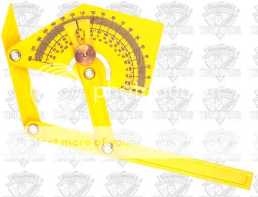

    Perfectionist - Try it for yourself? Get a angle finder and check your work for accuracy? Measure the length of your cutters?
    This angle finder is good enough and is common and cheap . . .
    If not a perfectionist . . .
    If you don't have a digital caliper, use a the jaws of an adjustable Crescent wrench?

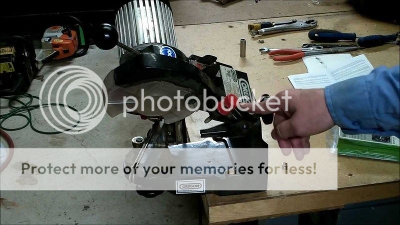

  19. w8ye

    dgeesaman, Cut4fun and Warped5 like this.
