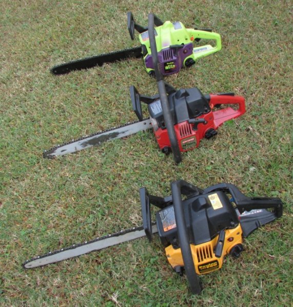

    I've had multiple 42cc Poulans - don't sell them short. You need a yellow/pro chain and they cut WAY better. Oregon 91VXL062G is a good one.
    The red Craftsman is the only saw I've ever bought new - 1994. Probably bucked 30 cords. Minimal maintenance has been required. If comfortable with it - I'd open muffler a bit and tune richer.
