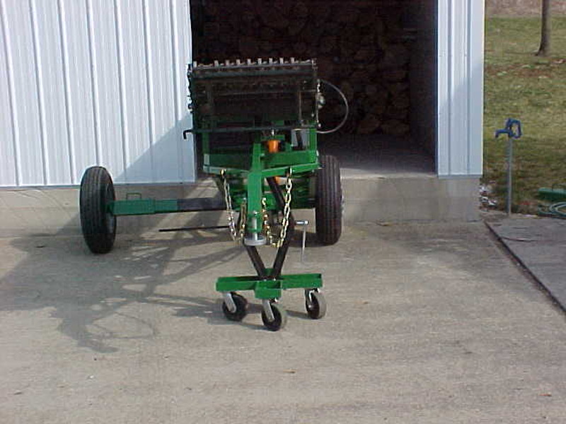

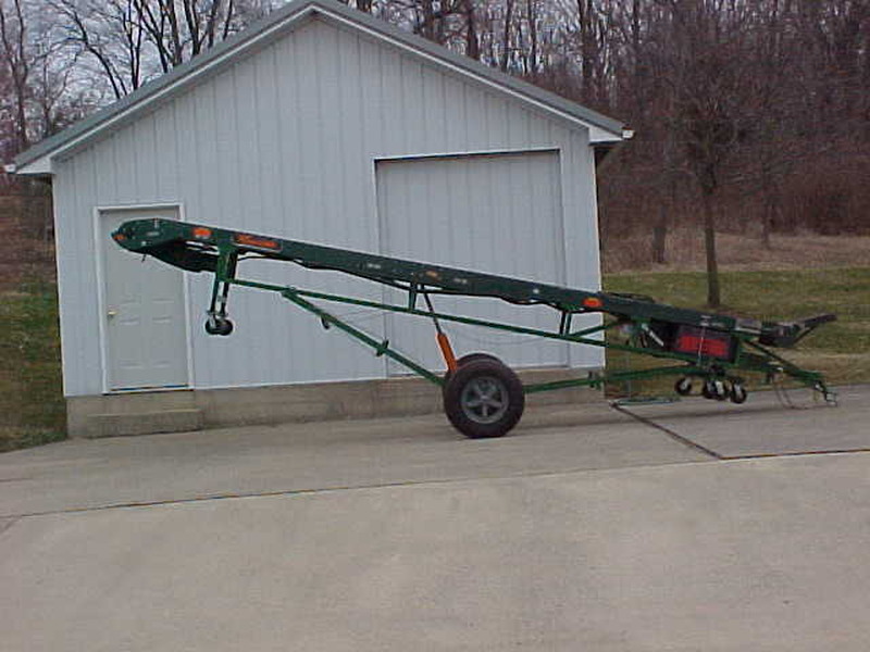

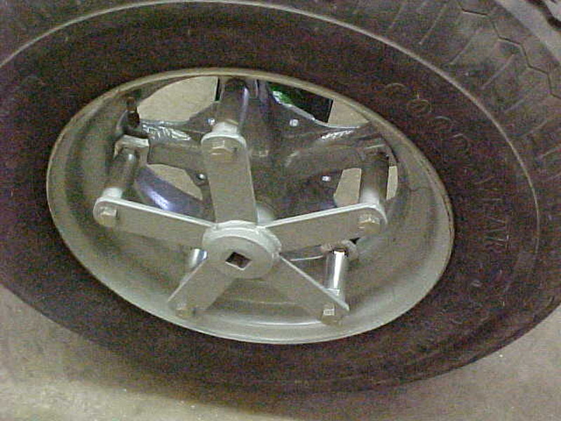

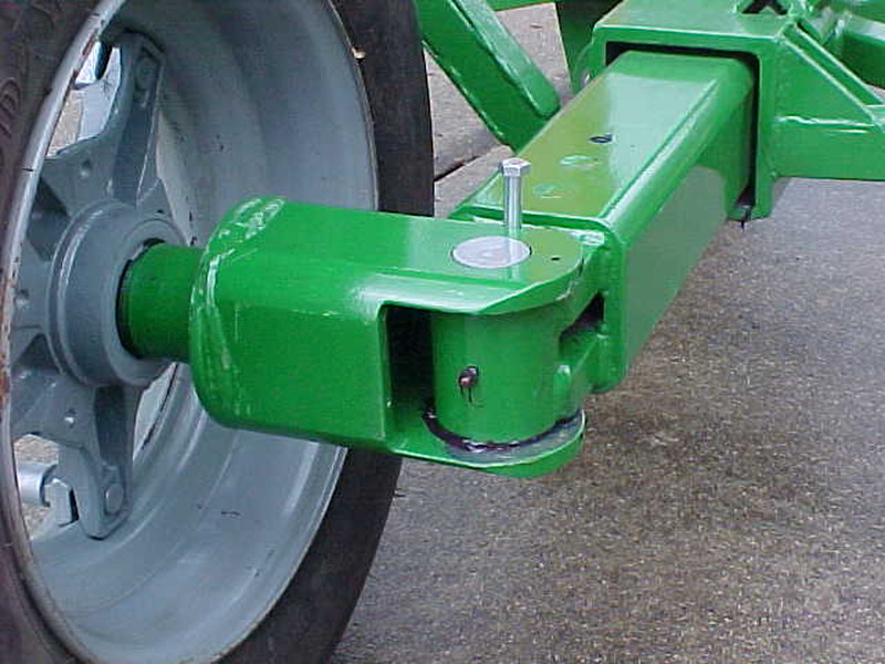

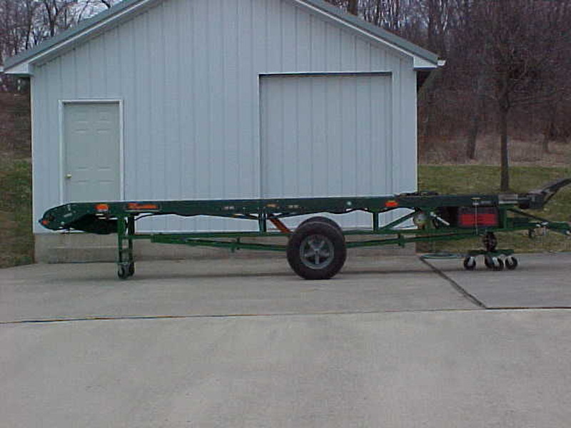

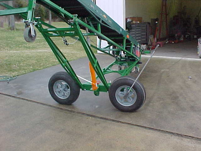

    I got one of those same conveyors from a Kmart as well. I wanted more than just a standard conveyor so I gave it some options
    Adjustable level flat table
    Normal adjustable conveyor.
    Sliding offset axle so you can load/unload from the side of a truck or trailer.
    Wheels can pivot 90 degrees.
    This is so you can move the conveyor sideways or in an arc if you are piling wood up.
    Put a 3/4" square drive on the wheel so you can move it easily with a 3/4" drive ratchet.
    Here is a link to how everything was made.
    conveyor
