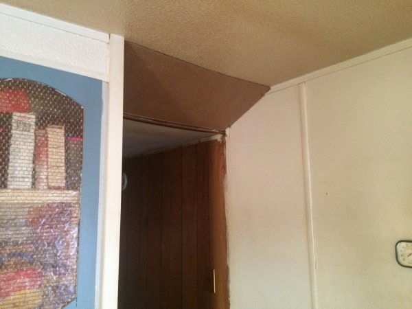

    Has anyone discovered any odd or unexpected airflow patterns in their home? I discovered a new one last night. It's nothing earth shattering, but it's very surprising.
    We have one of those old trailers where the front half is somewhat taller than the rear, and about 30 feet back it drops down (inside and outside). So the higher ceiling in the living room/kitchen area is about 7 1/2 feet, and then abruptly drops straight down at the hallway entrance, to 7 feet.
    I'd always wondered how that hinders airflow going to the back of the trailer, but never tried anything. So last night I put a heavy duty cardboard piece there with about a 40 degree sweep (tastefully shaped with a utility knife) with a few finishing nails, and wow, what a difference.!
    I kid you not, the airflow running back is equal to running a fan at the back of the trailer and pushing cold air to the stove room. I never measured (cigarette smoke in the convection flow) air speed, but visually it seems to have almost doubled. Is it possible for that smoothing out the drop could affect it this much?
    I obviously haven't been able to observe the temps compared to normal, but the back is warmer. Anyways, just amazed that a piece of cardboard and finishing nails made such a difference.

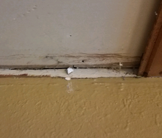

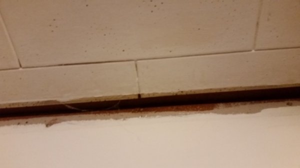

    Every room in my main floor has a 7/8" gap between the ceiling tiles and wallboard. No mud, no nothing. And, the ceiling tiles are just nailed to strapping so it goes straight to attic. I've filled most with foam weatherstripping then caulked on top of it. Still trying to figure out if I should pay someone to come in and sheetrock the ceilings or just try painting over the tiles and hope it seals enough to help keep cold from infiltrating. Course some of the tiles in the office and kitchen are so warped that there are small gaps so I'll have to do some replacing in those rooms anyway.
    House built in 1960 - hopefully they don't still build them like the "old days".

    That's exactly what our ceiling began like.
    The previous owner pulled the tiles and threw up some drywall. No taping of joints, etc. My bride (pre marriage) and her dad put up carsiding to cover the mess. The wood looked almost as bad and makes the room look small.
    I have most of it removed, in fact just now taking a break from it to get groceries.
    The people who installed the sheetrock used galvanized nails mixed in with drywall screws. Got to love it. :)
    I'm in the process of sealing the wall/ceiling joint and taping all the joints. Weeeeeee?! :)

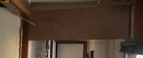

    In addition to the swept down piece mentioned in the first post, I put another piece half way down the hall (at an angle) to divert some warm air to a bedroom. Basically looking at a 4.5-5 F degree warmer temp down the hall with no fan now. It looks ugly but works way better than a fan. The temp in the stove room is obviously cooler (still plenty warm) so I'm pretty happy. Why didn't I try this years ago...

    My place is pretty ugly, but here's a cropped pic. It's nothing fancy, just cardboard at an angle, lets air above and below, but slows and diverts a fair amount of air.

    image.jpg Here's the transition from kitchen to hall. Again, I just put it up for a test and it worked so I left it there.

    Makes sense once I think about it. when the hot air hits a wall, it bounces back and interferes with other air coming at it. Those angled pieces keep the air from doing that and smoothly guides it around the obstacle.
    Even with my main floor of all even ceilings (relatively speaking), the air would get trapped by the header drop at the hallway entrance. I took the sheetrock on the header out when I was redoing sheetrock and found the air flowed much, much better - and my stove faces the hallway so I never thought that would be an issue.
