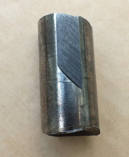

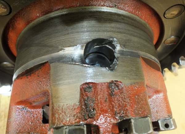

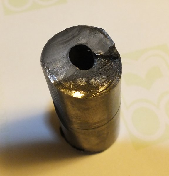

    The Old Girl gave me lift issues last fall and early this spring I decided to go into the lift to fix the problem. I got the lift cover off by mounting a winch to help lift it; its mass is around 100 lbs and it is cast iron. I went to work repairing the issues in the lift cover. The centre housing had bolt holes that were damaged and would need to be drilled and thread inserts installed. Since I would be drilling into the centre housing that also holds the hydraulic pump, I decided to drop the pump. When I unscrewed the PTO cover it was full of hydraulic oil; the seals were leaking. One more thing to add to the list. When I pulled the PTO shaft, I found a large piece of metal in the bottom of the centre housing. Now where did that come from? Well, it was a part of the spider in the differential, one of the arms had broken off. Many years back; before we moved here; Dad died before we could get the property and the house set up, water got into the hydraulic fluid and caused some damaged when it froze. I know Dad went in and repaired things. Mum and I also worked on the hydraulics after we moved here and that piece of metal was not present at that time. However, I started to notice a noise when lifting heavy loads. My guess is that the spider arm cracked all those years back and then finished breaking completely at some point. Well, that piece of spider arm got slung around inside of the centre housing where it caused more damage.
    I pulled the left trumpet and remove the differential and it could be repaired with a new spider set. However, the centre housing was damaged. I am not sure if that damage could be repair; I know there are good welders that can do cast iron. However, I managed to obtain a centre housing as well as the differential from a nice guy in New Jersey. Hopefully my friend will be able to bring them down to me as shipping such heavy objects is not cheap. I hate having to replace the centre housing since it is original to the tractor. However, several of the side cover bolt holes are stripped out; including the ones that support the running boards so they would have had to be repaired at any rate. I am rather sentimental about this tractor as it was Dad's tractor and it holds special meaning to me.

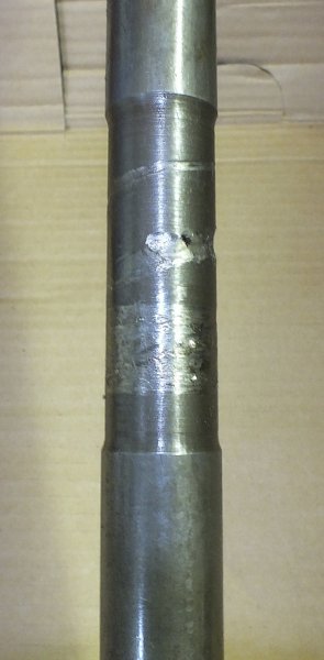

    PTO shaft.

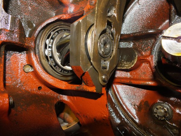

    It cracked where the pinion gear bearing is housed. Not good; if not for that, I would consider using the original centre housing. I don't know if that can be repaired.
    This is how she has been the whole year and now into winter. I had been waiting for the parts to get down to me so I can get her back together.
