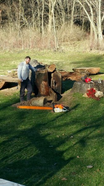

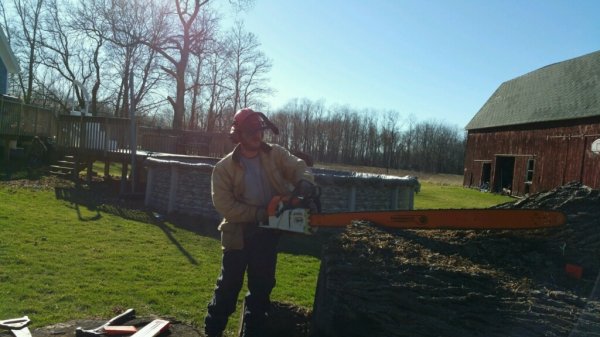

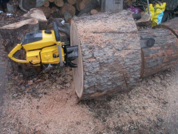

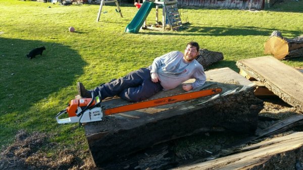

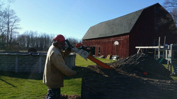

    You may have heard the term "noodling". This technique can be used to cut large rounds down to a more manageable size. The saw is oriented parallel to the long grain of the wood, and sawn this way the chips end up in long strands or "noodles".
    This technique places an intense load on the saw, so select the most powerful chainsaw available. The round is laid on its side, and the cut is made top to bottom lengthwise.

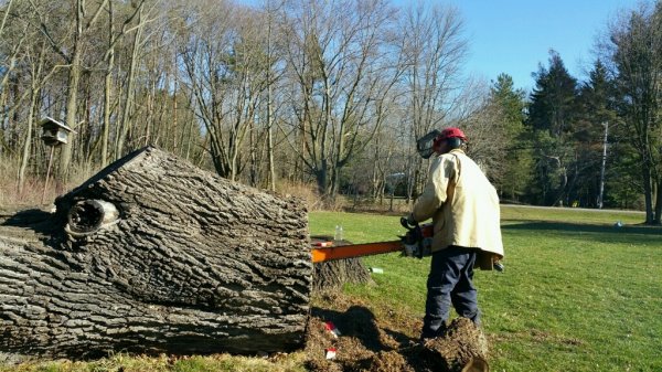

    Sometimes the noodles can start to jam up behind the clutch cover, especially if your saw has an outboard clutch or narrow cover. Varying the pitch of the saw cut will produce shorter noodles that clear easier.
    To avoid dragging your chains through the dirt, an axe or wedges can be used to finish the job.

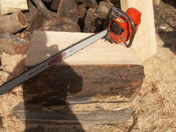

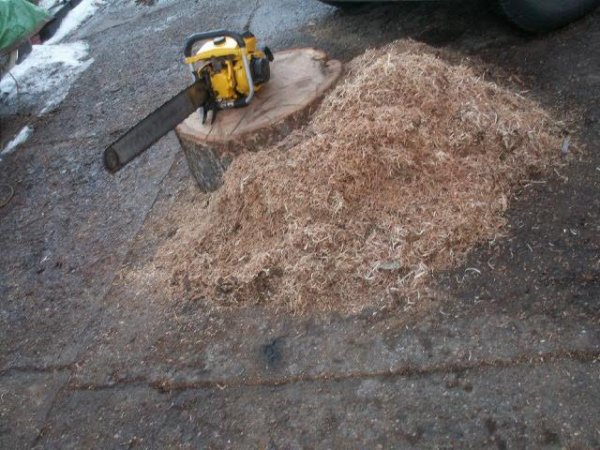

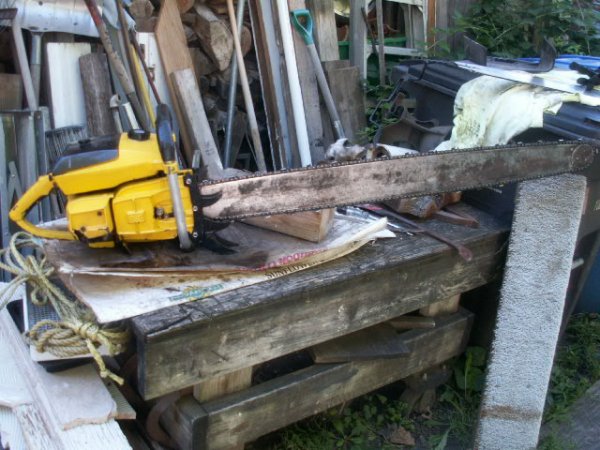

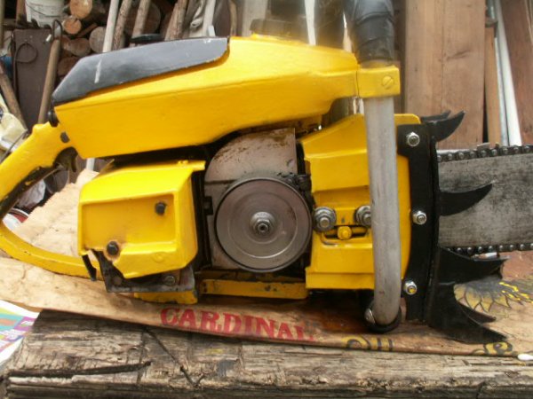

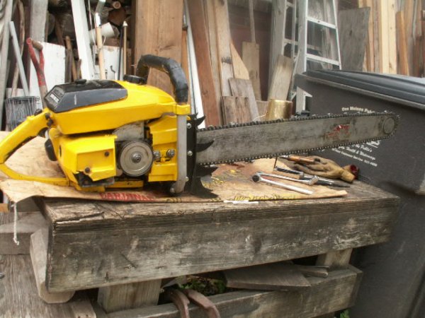

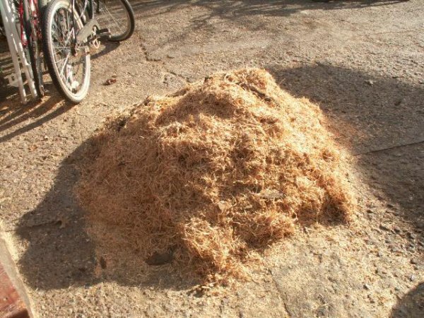

    LOL I was noodling 30 years before I heard the term.....;)
    I solved the jamming problem on my Mac 125C by swapping out the original clutch cover for one I modified.
    The 125 has more power than any stock saw sold in the past 40+ years,chips/noodles will really pile up fast.
    Didn't want to destroy the original one so I located a cheap slightly battered one from one of my West Coast contacts...:D
    All that mattered is that the bar stud holes were intact & hold securely.

    I made an open "clutch cover" from a 2x4x1/4" blank of aluminum plate specifically to noodle.
    You just need bar stud holes, and an additional hole for newer side tensioners, all edges chamfered with a hand file. It works like a champ but if your saw needs extra supporting structure find a beat clutch cover and follow thistle lead

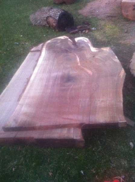

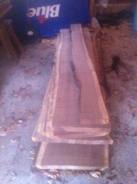

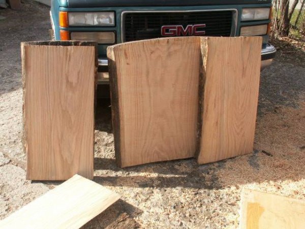

    It's true.... :emb: My pile of black walnut slabs is smaller than I'd like it to be. But I'm working on it... :)
    These ones are about 50" wide.
