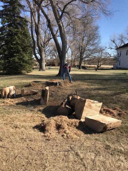

    Last Sunday I had to noodle about 25” into some 28”+ dead elm trunks to get em to split. Was using stackable plastic wedges and an axe to drive them. I need a thicker steel wedge C4DB87CE-50DF-4416-A7E5-AB2F5CB19BAD.jpeg
