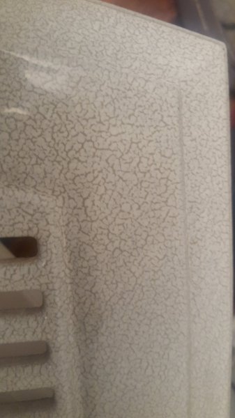

    Here's what the PE antique white actually looks like. It actually hides dust really well. Then when it come time the glossy smooth surface is very easy to clean.

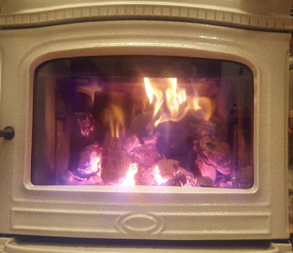

    Here's the T5 cruising tonight on a laod of black birch and cherry. 20171214_221824.jpg
