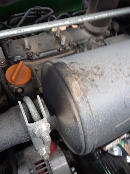

    Smoking pretty bad, esp on startup, thick grey smoke, a small stumble every few seconds...46 hours on it:mad:

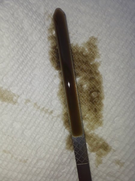

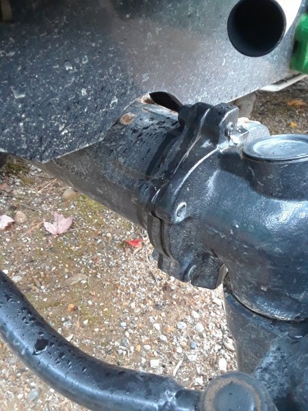

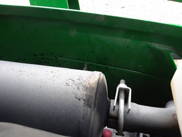

    Pics, Thick, black, oily liquid blowing out from around the muffler, and out the exhaust on the frame. Oil on the dipstick looks "milky", hard to see in the pic. The coolant level in the overflow is down.

    Milky oil means water in the oil...either you submerged it (doubtful) or you have coolant leaking into the oil...don't run it anymore than is absolutely necessary to get it on the trailer back to the dealer (or make them come get it with a rollback)

    Brand new diesel? that means teir 4 emissions equipment- I will guess that is where the problem will be found. Yes, you have coolant in oil. If it has a turbo means the intercooler system is bad.
