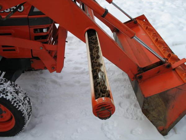

    I have also seen people make PVC tubes to slide into the front end loader to store chains and straps. Any additional weight reduces the lift capacity of the FEL, however keeping smaller chains there wouldn't be an issue.
