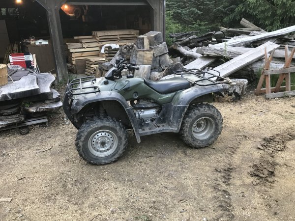

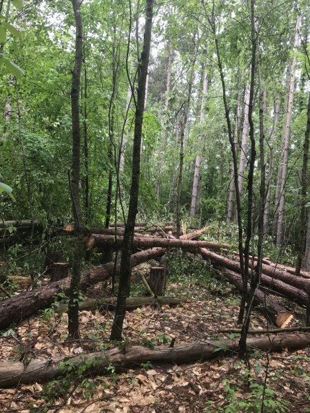

    New to me anyway - 2006 Honda Rancher 350. My dad bought it from a neighbor a couple years ago but he didn't end up using it much. I was in the market for one cause I've got about 50 trees down in my woods and my trusty JD mower just wasn't going to cut it anymore. So I offered to buy his. I'm hoping to be able to pull 8-16' logs with an arch; hopefully it's enough.

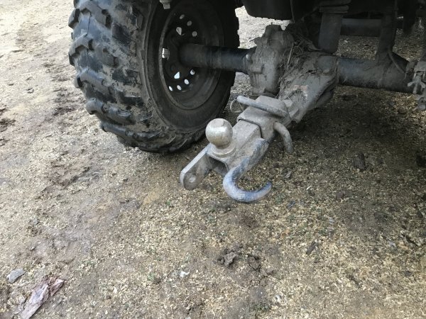

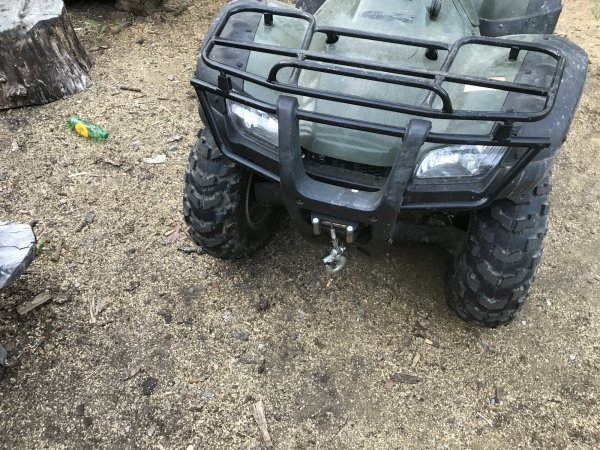

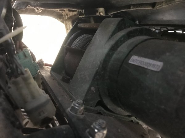

    It's got a winch and a pretty cool receiver hitch but neither seem to be the best setup. The winch doesn't stop immediately when you release the button, and the hitch is mounted to the axle. So I'm thinking about some upgrades there.
    I gave her a spin around the trails tonight but haven't tried pulling anything yet. I'm excited to see what she can do.

    On the winch... Get it out and clean it up a bit... Maybe some electrical cleaner and then reapply some water proof electrical grease back in it when reinstalling it. It might be a bit gritty and gummy... :yes:

    I can't help but ask though...why wouldn't you want the hitch attached to the axle?

    Well if I'm yanking on logs and so forth I'd hate to damage the axle - I'd rather it bend the frame. The manual says max tongue weight 30 lbs, :confused: and max pull 850. I ended up ordering an aftermarket receiver that bolts to the frame from Kolpin, who also made the 3-way hitch that's on there now.

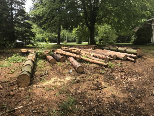

    I don't have much "terrain" here at all; it's very flat. So I was hoping I could get by with a smaller cc unit. Milling is definitely the main goal, but this time I'm going to hire a guy from Eden NY with a wood mizer LT70. When all is said and done I'm probably going to be looking at well over 100 saw logs in the yard.

    I see what you are getting at but if the hitch is on the frame, wouldn't it be taxing the bike's suspension? The axle will still be bearing the load, albeit with fully compressed suspension?

    Well I guess I don't know. I think I'll feel more confident in a straight pull if it's attached to more than just the axle. And I think the suspension would take a lot more than the rated 30lbs tongue weight before fully compressing the springs. The factory mount just seems rather light duty. I won't have the new receiver until next week though and I know I won't be able to resist playing in the log pile this weekend, so hopefully it's stronger than I think.

    After looking at the log arch hitch again, its not real HD, so apparently it doesn't place a huge vertical load onto the ATV, I'll think you'll be fine absolutely with the factory hitch...which is the piece bolted to the axle housing. That aftermarket 3 way receiver hitch that is bolted to the factory hitch needs to come off...the leverage from the 3 way will put an awful lot of extra stress on the hitch/axle housing...I personally wouldn't use that on an ATV. As far as the 850# pulling rating...you won't hurt that factory hitch...you'll lose traction before you hurt that hitch...unless you are on dry pavement or something...even then you'd probably do a wheelie before hurting the hitch. Again, this is the Honda hitch only...3 way/receiver removed.

    As for the winch not stopping immediately when you leave off the button, it should...so either the button is sticking, or the winch motor power relay is faulty in some way...pretty much the only two options.
