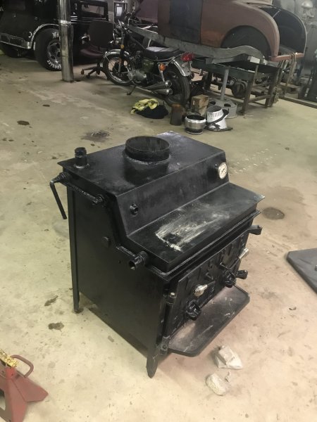

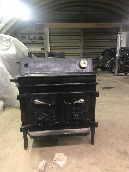

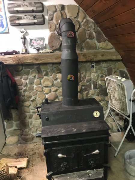

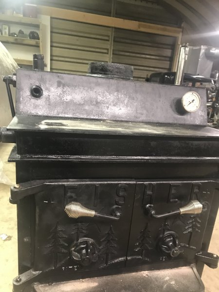

    869B68C4-FFCE-4602-B3CF-CF8C184B8F48.jpeg FB39AEA4-D296-477C-B513-1BE125CE3B0E.jpeg 5268FBEF-EF58-4709-9DCF-B3FDC0FB3AE3.jpeg Hey all. My names Fred and I’m from upstate NY. I’ve been burning and cutting firewood my whole life. I just picked up this bicentennial Grandpa Bear. Overall in really nice shape. Has anyone ever seen one with chamber on top plumbed for hot water heat? It has about a 3” thick space on top plumbed with an inlet and out let. And another inlet and outlet that has a looped pipe in the chamber. I don’t believe this is a homemade addition. The quality of the welds and fab work are the same as the rest of the fisher. Anyone ever see or hear of any old fishers like this?? Thank you. Fred.

    Hey Fred great to have you. Looks like you’ll fit right in, talking cars and fisher stoves. I’ve never seen a fisher done up that way,but I’m sure one of the many weld shops that produced fisher’s could have done it as a option. There are other’s here with greater knowledge who will shed insight on this. Either way it will heat that shop nicely,they are great stove’s.

    Thought maybe we had a stroker-stove there with what I thought was a by-pass handle on it where someone had maybe added it and secondary burn tubes inside, but I guess it’s just plumbing.
    Shucks...me could do a stroker-stove!

    Water in the stove will be a creosote generator, on the water pipe and a potential problem in the chimney.
    I heat with a Fisher, they're a good stove. but I wouldn't use the water line if someone had added it to my stove

    A round of beers is not a problem as long as you like PBR! I've been fine tuning the fisher here and there after work. Messing with baffle size and angle. My pipe going through the wall is 6" so I have no choice but to reduce 8" to 6". I swapped the 6" elbow to an 8" then to the reducer. This ol' girl drafts like a locomotive! It looks like I'm getting a pretty clean burn to out of the stack. It will hold coals easily over night.

    I use a Baker wood/coal stove but have seen many Fishers online for sale. I’ve never seen any make with the mods you posted.

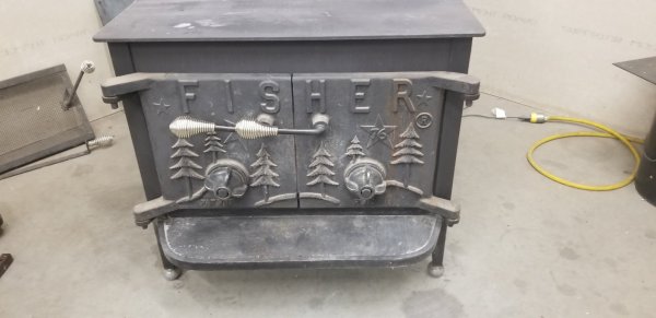

    That's an interesting Fisher modification, does your Piping go straight up and out or do you have a 90 degree in somewhere? Welcome to the FHC. I grew up in Eugene/Springfield, OR so I really like Fisher stoves, 1 of 3. :) 20191120_121658.jpg

    The 2 ports on the top portion of the stove that come out of the side have a 1" tube that loops through the top of the stove and connects the 2 fittings. The 2 larger fittings just go into the 3" chamber on top of the stove. Like I said the quality of the welds and fabrication lead me to believe it is a factory add on from Fisher. Unicorn1 I see yah like to collect old Homelite also. I've got a small collection. A couple super EZ's, a 150, a 360 auto and a Super 925XL.. I love them old saws!

    Nice to meet you Fred :) I'm leaning for water too, maybe a pool or hot tub? Maybe a cabin without heat for hot water? Total guess.

    That set up would be great for a red neck stock tank hot tub!!!
