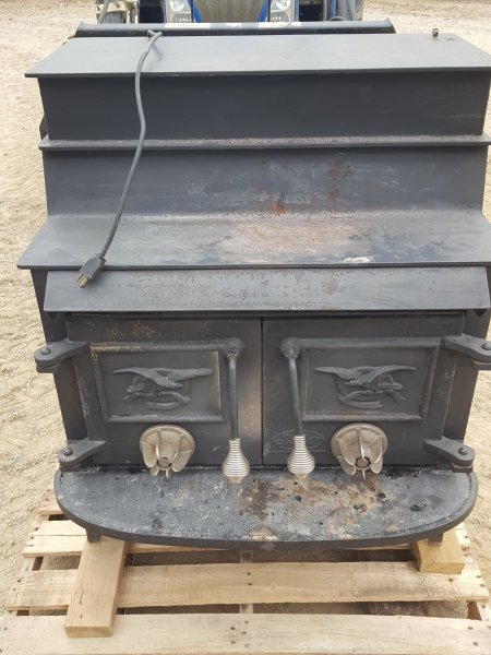

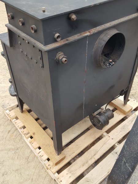

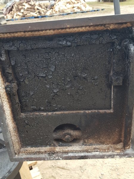

    This stove was in my neighbors house but they never used it. It was hooked up to the oil fired baseboard heat system. This brand was made starting back in the 70's when oil prices started to climb and was mfg. into the early 2000's. They must have sold thousands. Neighbor sold the house and the people that moved in were using it. I knew the wood they were using was not ready to burn and I even showed the guy the moisture levels of the wood he was cutting and hauling in. Fire co. showed up one time because of the CO2 detectors going off. You can see the creosote on the door. Anyhow another really nice couple bought the house. I saw him hauling pellets in one day and asked about the woodstove. Took it out and using pellet stove. I told him I was interested in the woodstove. He called Saturday and said he had the stove out in the driveway. We had never talked price. Went over with the tractor and forks and hauled it home. The price? Wasn't more than a dollar. :thumbs: This stove probably sold for around 2 grand new. The Wood Wolverine knows how heavy these things are. 20210125_110833.jpg 20210125_110821.jpg 20210125_110901.jpg

    WOW! That was quite neighborly of them! I’d love to know the gross weight on it. That’s one job I’d never want to say I did, deliver Bakers!
    Where’s it going Steve, in the shop?

    Not sure the weight Jason but when I picked it up with the tractor I knew it was there. Heavy sum beech. Not sure where it's going but probably the shop. Need to figure out what I need for plumbing and an exchanger.

    Oh yeah, I’m dying to see what your plans are for this beast. I bet it could make a good pool heater as well.
    Does it have a coil on top of the firebox? It that a coil/plate on the side?

    Me too. Yeah, does it have an exchanger in it?

    As far as I can tell it has a coil for domestic hot water and a coil for hot water heat. My plumbing buddy already has big plans for it in my shop.:makeitrain"As soon as the weather cooperates I'll get it outside and give it a good cleaning. You guys wood have heart failure if you saw the creosote buildup inside the stove.

    That stove is a good candidate for glass windows and a secondary air tube modification. Those Bakers are well built.

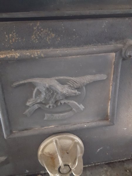

    Some came with the glass option. Most of the people I know switched to the metal plate after their glass broke. I forget what the glass cost but it was a pretty penny. I like the eagles on the doors.:usa: Not sure what you mean for air tube mods.

    Adding a secondary air tube will improve the overall efficiency of the stove. Helps to re-burn the gases in the upper part of the stove before the gases can leave the firebox and condense in the flue.

    Don’t have a problem feeling Patriotic with that stove, for sure, so I understand that.
    However, today’s glass is super durable. If you search you can find videos on YouTube of them heating a piece of glass real hot and pouring liquid nitrogen on it without it breaking from thermal shock. Pretty impressive. Here’s just one example...and eagle’s can be etched into the glass.
