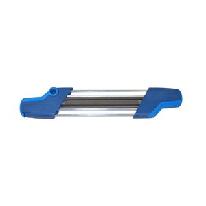

    I use a Pferd sharpener like this to keep the edge on the teeth, usually hitting them with a few strokes every tank or two of gas.
    The best part of this design is that it takes the raker down at the same time as the teeth, so no extra steps when sharpening.
