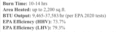

    The IS output can be trimmed down to 9,4xx BTU, I doubt the NC30 can go that low (without modifications).
    As Highbeam mentions, small fires in a big stove, while it can be done, is a pain in the rump and far too often quite uncomfortable.
