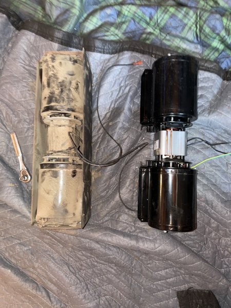

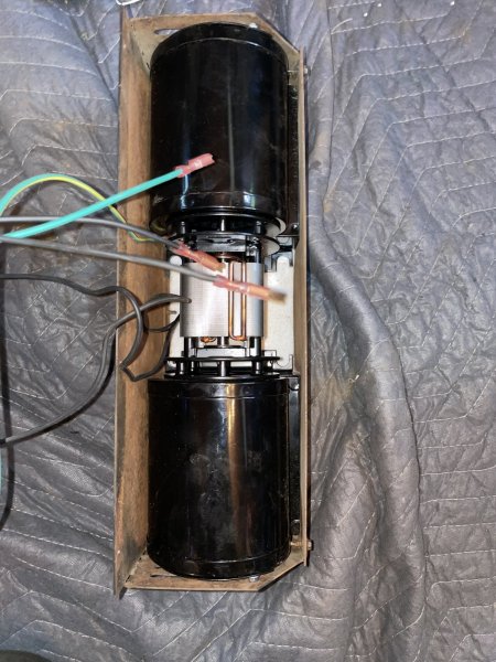

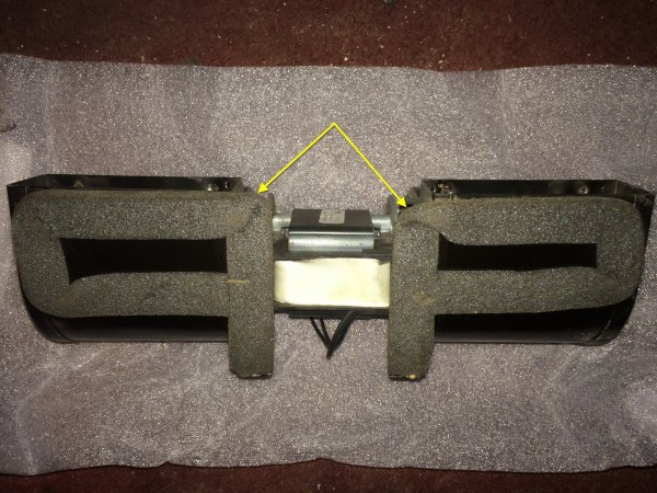

    The most popular blower for many St. Croix pellet stoves is the:
    80P20003-R
    Since many of these blowers are mounted under the stove in a metal box like the popular St. Croix Hastings, the engineers had a fix for the vibration noise by gluing foam to the bottom of the blower.
    I just got a new blower and there is No Foam!

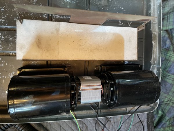

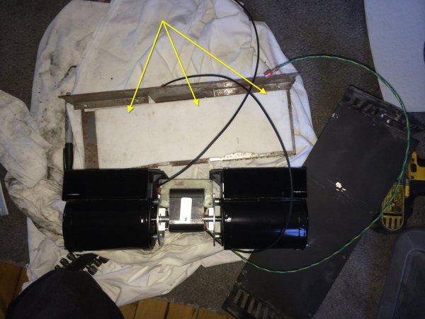

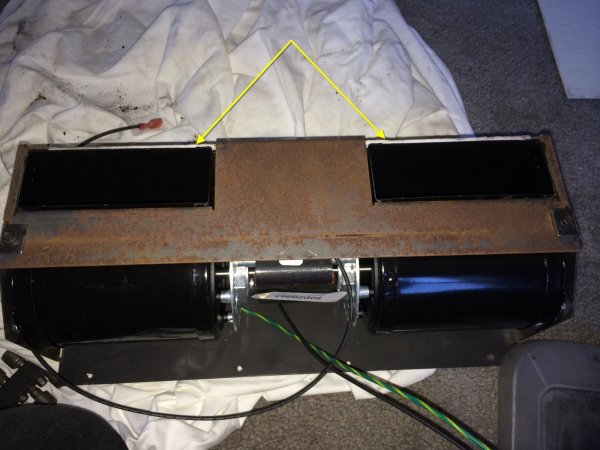

    So I pit in a strip of white lytherm which is high temp and a good cushion.
    What did you guys do?
    (See Yellow Arrows)
    Pic 1 - Old blower with foam.
    Pic 2 & 3 - New blower with White Lytherm

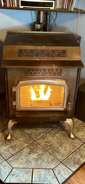

    Hello
    This original St Croix Prescott did not have any vibration foam!
    This St Croix Tangential Convection blower smoked making an electrical burning smell and then the internal thermal overload circuit tripped! After it cooled down when the stove was started again this blower made a very loud grinding sound!
    So in goes a new tangential convection blower and in goes some white high temp gasket material for anti-vibration!
