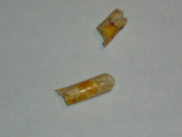

    My local softwood pellet maker Lacwood's (200 miles north of me) are secretly putting extra BTUs into their pellets, guess what it is?

    Corn, Some mills use it to clean the dies from what a mill rep told me. From what he said, If they get to dry a mix they will put some corn in to help control moisture and remove the dry cakes that build in the mill die. Corn holds a lot of moisture. So a small amount can raise the moisture level pretty quickly.
    Are you seeing a whole lot of it?

    Just the occasional time being. I wasn't aware of the usage of corn in the process of pellets, good to know. It's sure better than what other people have found, somewhere no one wants their stove to find for them:eek:

    Technically they are supposed to list the adders on the PFI label . Yours should say corn and might say as die lube if they carry a PFI label.
    This should help with the unwanted stuff in the mix. I'd be leary of any pellet company that carries a PFI label and isn't listing its adders/fillers on the label. If you visibly see an unlisted adder, Please post so we can get PFI involved. Lets make them actually earn their money and do something useful! ;)
