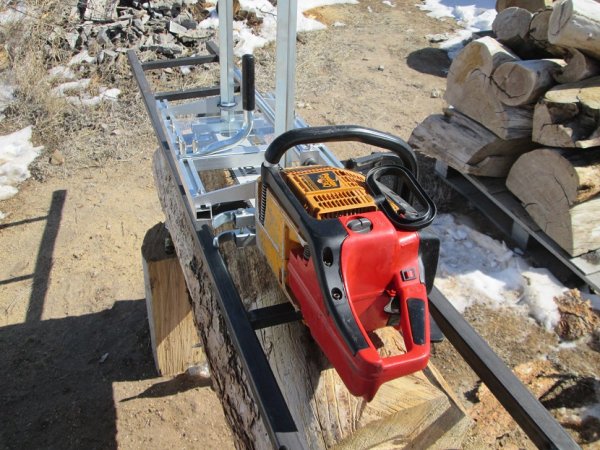

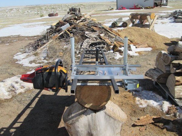

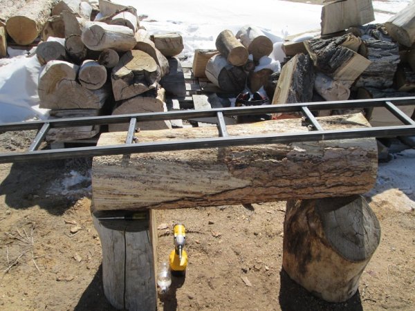

    So I decided to get one those saw mills. I believe it will take a 28" bar but I am using 24 on it now because that is all I need.
    I am not carpenter at all but I think I can make a simple table or bench or wood box for inside the house so I went for it.

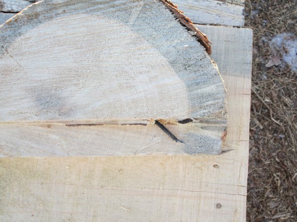

    I had some beetle kill lodgepole pine so that is what I am starting with. For the most part it went very well for my first experience at this except for the huge log screw I hit. Wiped out the chain so bad I threw it away.

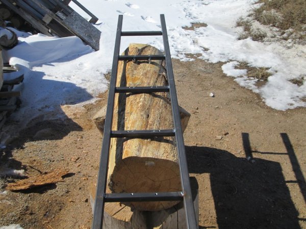

    I built the rail guide myself and put some leveling screws on it which I like because it helps to prevent the rail from flexing when screwing down.
    Some pics.

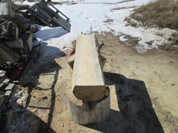

    Some more pics.
    The log screw I hit. I must have been 8 inches long.

    Nice! Except for that 8” screw :headbang:

    Yea that screw really messed up the chain.
    The saw I am using is a Poulan 505 which is 83cc and it has a Stihl MS 660 piston in it and the saw has been ported. Seemed to cut and work real well for this application.
    I took a round ground chisel chain and square ground it. That seemed to work ok too. I read on one of the forums somewhere that square ground chain worked well.
    By the last cut I did notice it was starting to slow down a little.

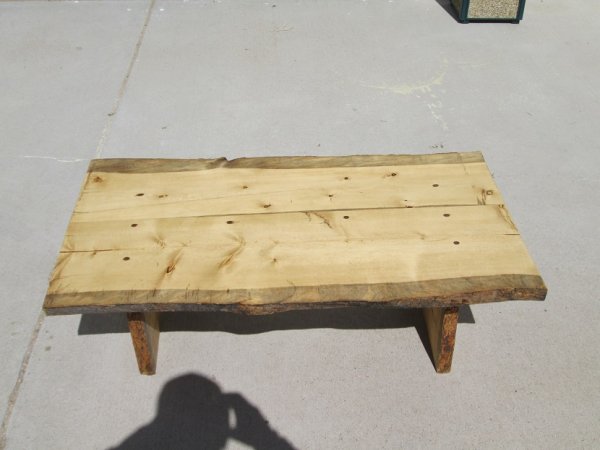

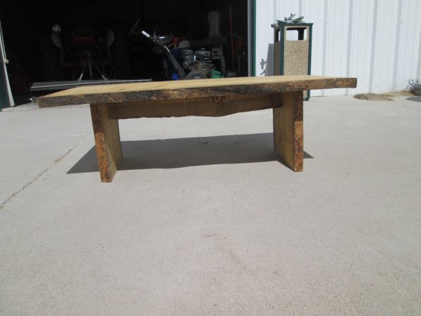

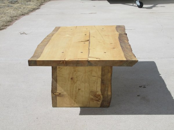

    Well I got around to making a simple table to sit out on the front porch for when I am having a good cigar and a beverage of choice.
    Like I said I am not a carpenter by any means but this will work and I do like all the natural edges to it.
    I did not take it down real smooth since it will sit outside year round. It is only stained right now and I have an exterior finish that I will put on it for protection.
    I will see how it goes since this is all new to me at this time.
