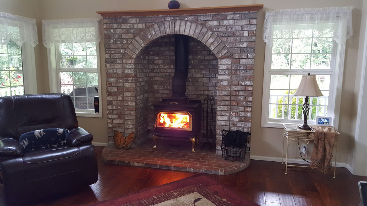

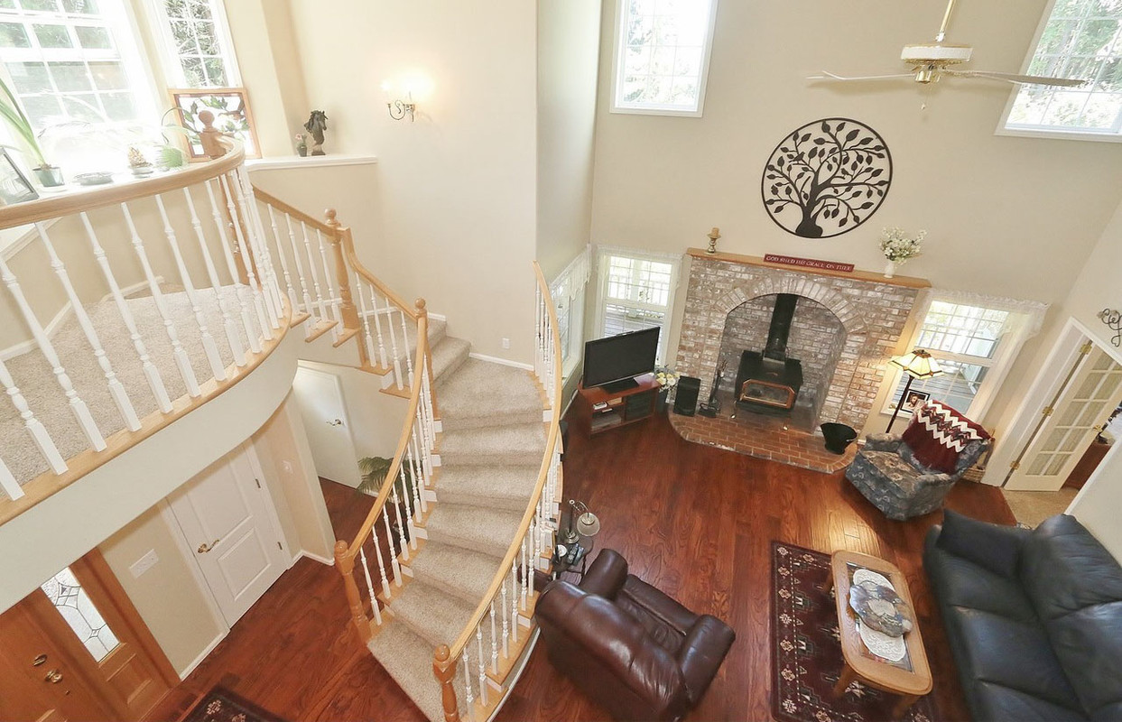

    Great question! Sounds sort of like what I have. (??) See photos. In this house I would like to lower (or eliminate) the archway far enough down so that I could put a nice mantle above it, then recess a shallow area for a flat screen TV above the mantle. May eventually do that as, like you, the floor space is an issue.
    I took a look at your plans - nice! I also had built a house where I was in your exact situation... and flinched due to the added price of the flue work, went with a gas fireplace as is pictured in your plans - and hated it. Gas fireplace looked nice, but didn't heat much of anything. I don't think any of us here would ever give up our woodstoves - we went without electricity once for 11 days (snowstorm) and were warm and cozy.

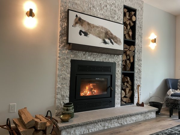

    75A95B57-5559-4766-BBA0-EAB1AC499FF6.jpeg Here is our Kozy Z42 zero clearance that we installed last year. It’s been great to heat our basement/house this past winter. I added a custom blower / heat dump kit to pull the heat upstairs when needed or if the basement gets too warm. We’ve been very satisfied with the quality and performance. mikedub
