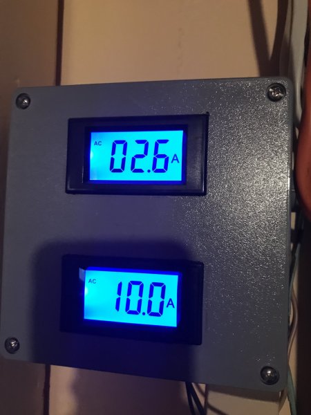

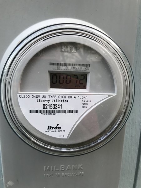

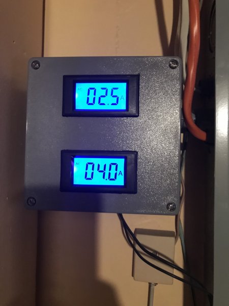

    I am checking out the new digital electric meter the power company just installed to replace the approx 60 year old meter on the house. Right now it says the draw is 72 KWH and my load is about only 12 amps so I shut down the pool filter which took off 6 amps and no change on the meter - still reads 72 KWH? Why? See pics
    Is this calculation correct?

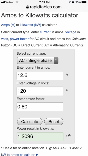

    I am assuming an average power factor for all my loads of approx 0.80 ??
    So from the online calculator set to AC single phase 120 VAC the 1.2 x 60 mins is 72 KWH
    However after shutting off the pool pump, the meter did NOT change with a 6 amp load drop?
    Should it read?
    6.3 amp load using the calculator and 0.80 average power factor times 60 mins is 37.8 KWH ??

    The meter is reading the total electric you have used since it was installed...it keeps a running tally. You are billed per KWH

    Like the odometer on a car?
    stuckinthemuck and brenndatomu like this.
  6. brenndatomu
    20,553
    128,074
    Bingo.
    If you took a look at your old meter before they took it down it probably would have read somewhere in the hundreds of thousands...the total KWH that was used in your home over those 60 years.
