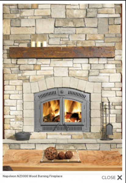

    With a zero clearance insert, you can literally build a wood frame to finish as you wish, as opposed to a traditional insert, which would require a masonry fireplace.
    Scotty O’s Napoleon is a zero clearance IIRC.

    Yeah, a zero clearance will be great for a new construction. Inserts, like I have in my existing former open fireplace, work great, but if you are building new, then you can add a zero clearance.
    If I were you, I'd put in a Napoleon NZ 3000. I think that's the one Scotty Overkill has. That is the best of both worlds. If your wife is like mine, and it sounds like she is, she'd love the look, and you'd love the efficiency.
